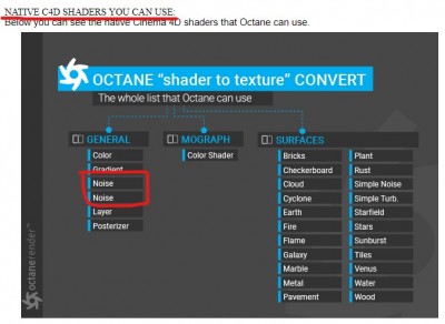

But I thought procedural C4D noises were now supported, and we no longer had to bake procedurals into textures...
Is that not the case ?

Posts: 16068
Location: Türkiye
HTK421 wrote:But I thought procedural C4D noises were now supported, and we no longer had to bake procedurals into textures...
They are not yet supported by helping of osl scripts. Planned for future
