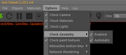

Geometry->Automatic
Geometry->Automatic

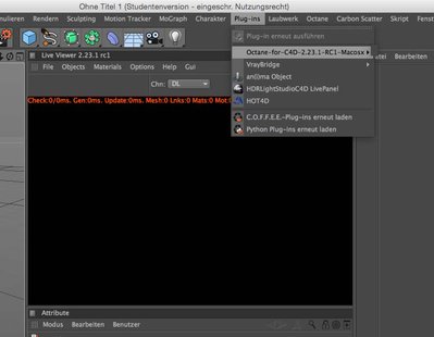

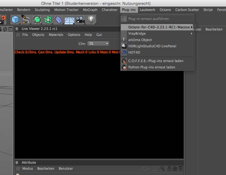

Hi Aoktar,
you are superfast once more. I was curious and installed the Mac Version, but it looks like this.
Also I got a crash.
best regards
D
_BugReport.zip
(19.74 KiB) Downloaded 391 times

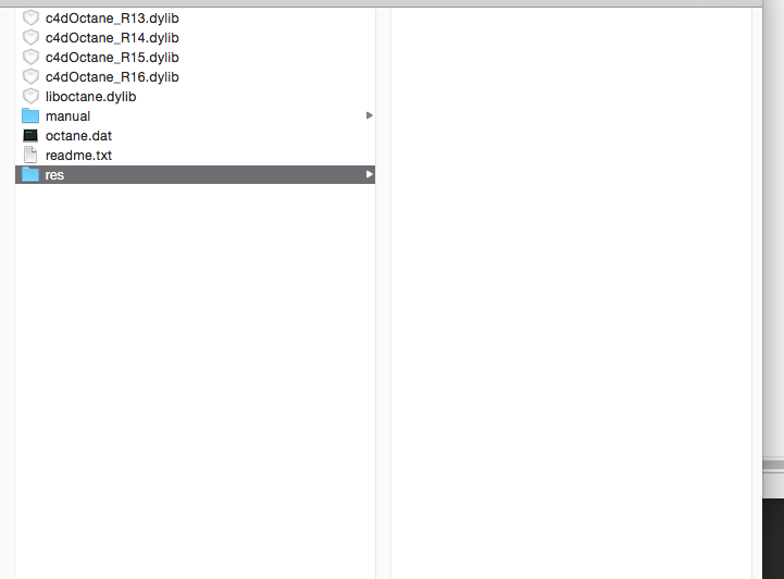

albehany
Posts: 62
Joined: Fri Jan 03, 2014 3:37 am
Location: riyadh saudi arbia
because the res folder is empty and have no file :)
and thank you ahmet for your handwork
Posts: 16068
Location: Türkiye
can you use the "res" folder from Windows version? I'll fix it asap

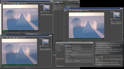

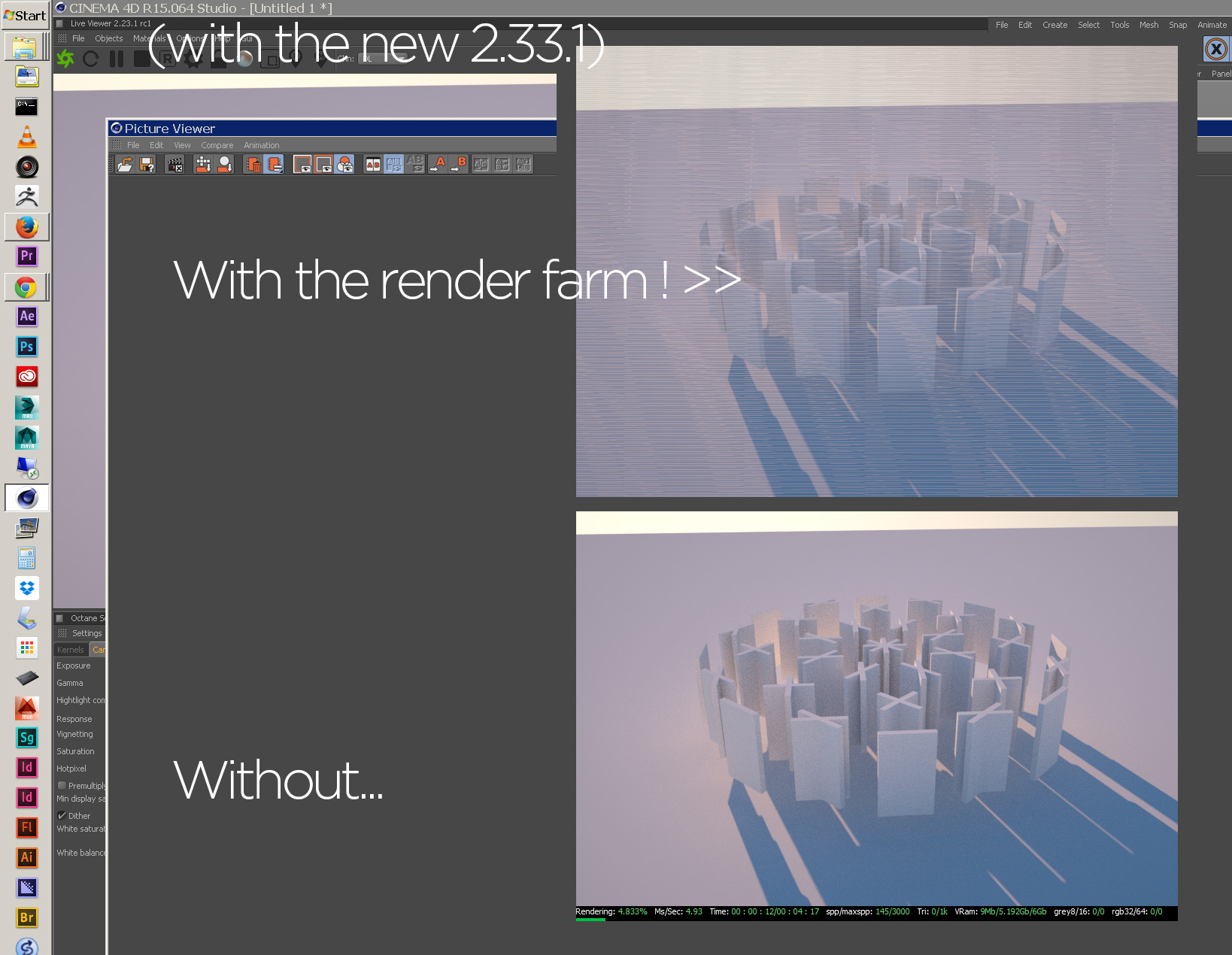

same problem with this new version.
problem.rar
(67.26 KiB) Downloaded 425 times
Posts: 16068
Location: Türkiye
eightvfx wrote:same problem with this new version.
problem.rar
Can you try different variations of this scene? Maybe some straight geometry without arrays.
eightvfx
Posts: 40
Joined: Thu Jun 26, 2014 6:36 pm

albehany wrote:because the res folder is empty and have no file :)
You're welcome. I have fixed the osx archive.
