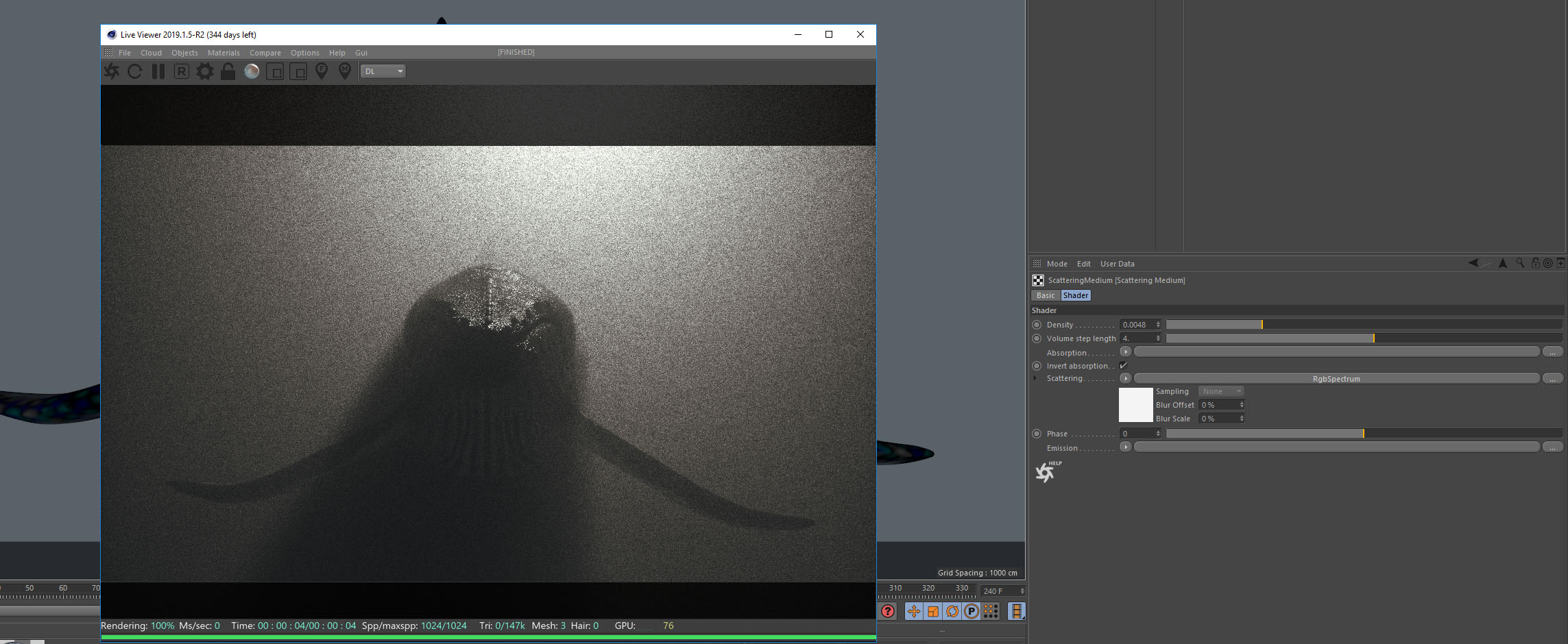

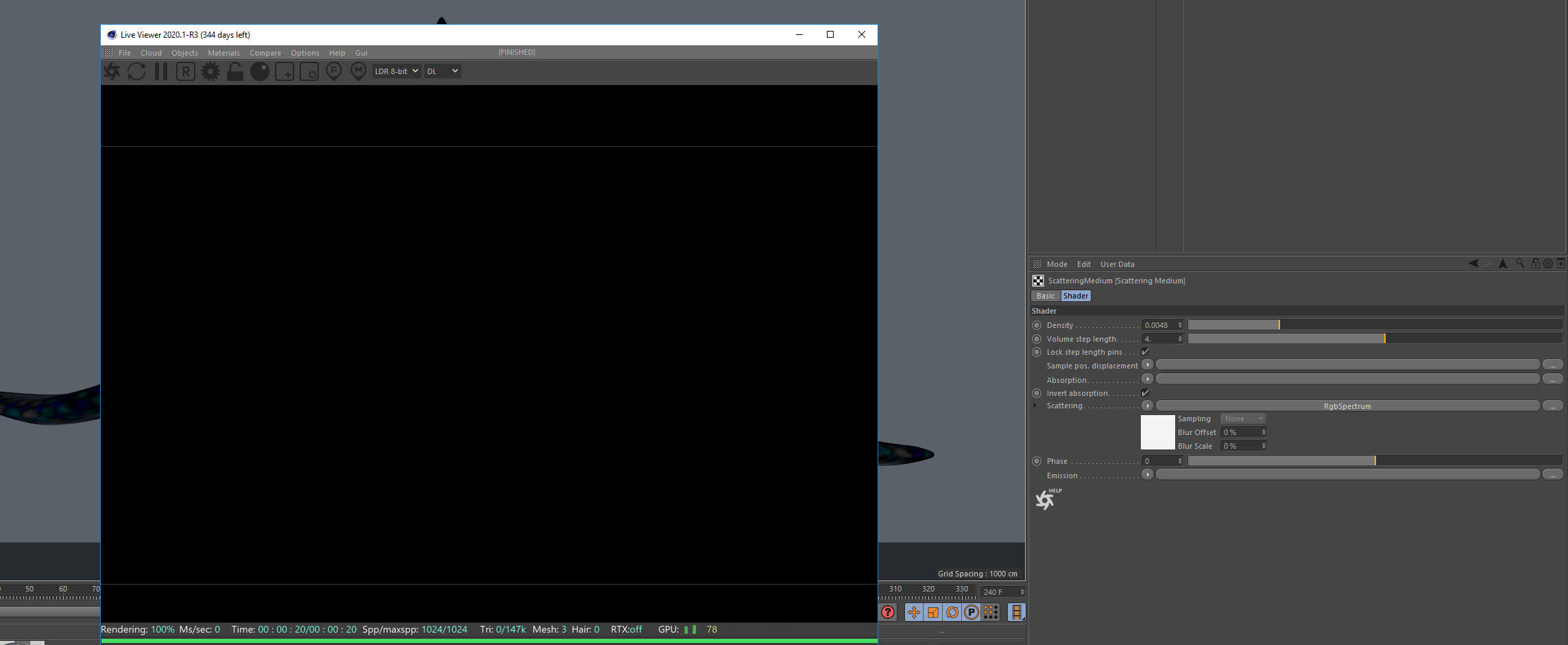

Hi Ahmet, great release, love the added native support for c4d shaders. One problem I've found is that OctaneSky Fog doesn't render properly anymore (please see attached images, same exact scene rendered by 2019.1.5-R2 and 2020.1-R3). Also, there is a big difference in rendering times.
Has changed anything about Fog since 2019 release? I've tried three different foggy scenes I had and they all present the same problem, they all render out very dark or black, I've tried to play with parameters but I can't seem the get the exact same look as the old ones. Also, "Emulate old volume behavior" seems to have no effect.
Could you help with that, please? I'm on C4D R20 if that can help. Please let me know if you need to inspect this scene.

Core changes are not up to me, but share a sample scene to compareDomenicozzo wrote:Hi Ahmet, great release, love the added native support for c4d shaders. One problem I've found is that OctaneSky Fog doesn't render properly anymore (please see attached images, same exact scene rendered by 2019.1.5-R2 and 2020.1-R3). Also, there is a big difference in rendering times.
Thanks,
Domenico

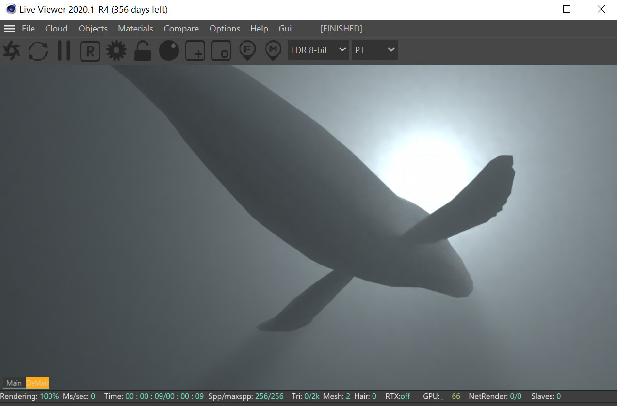

Domenicozzo wrote:Check your scene, object scale.aoktar wrote:Core changes are not up to me, but share a sample scene to compareDomenicozzo wrote:Hi Ahmet, great release, love the added native support for c4d shaders. One problem I've found is that OctaneSky Fog doesn't render properly anymore (please see attached images, same exact scene rendered by 2019.1.5-R2 and 2020.1-R3). Also, there is a big difference in rendering times.
Thanks,
Domenico
Enjoy it!pxlntwrk wrote:it's really great Aoktar! a real productivity gain on the user side.
Use the actual scale is possible.
Here is the scene with the fog problem, thank you Ahmet.[/quote][/quote]
Thank you for the help, @eyeonestudio.
Yes, the object is pretty big, my main concern though is why in 2020.1 I can't see nothing with the frontal camera, while with 2018/2019 it worked out. If you try to look thru the frontal camera in your scene (scene attached) it's still all black, tweaking the light won't help to get the proper original look.
Would love to know what changed with the fog system in Octane core, so that might help to get back the original look, which, additionally, rendered even much quicker (with 2019 release).
