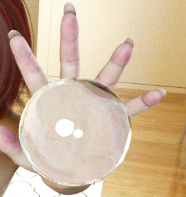

I have an object that acts as a magical ball/sphere. it got all kinds of textures/materials. generally, it's a sphere with a special textures. Octane doesn't import it correctly.
here it is in firefly:

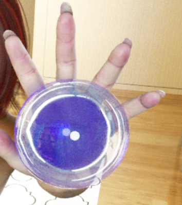

this is how octane imports:

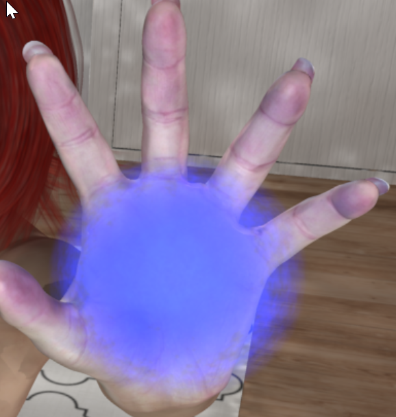

after some tweaks (color change/opacity) that's what I could get. it won't show the "magical" texture:

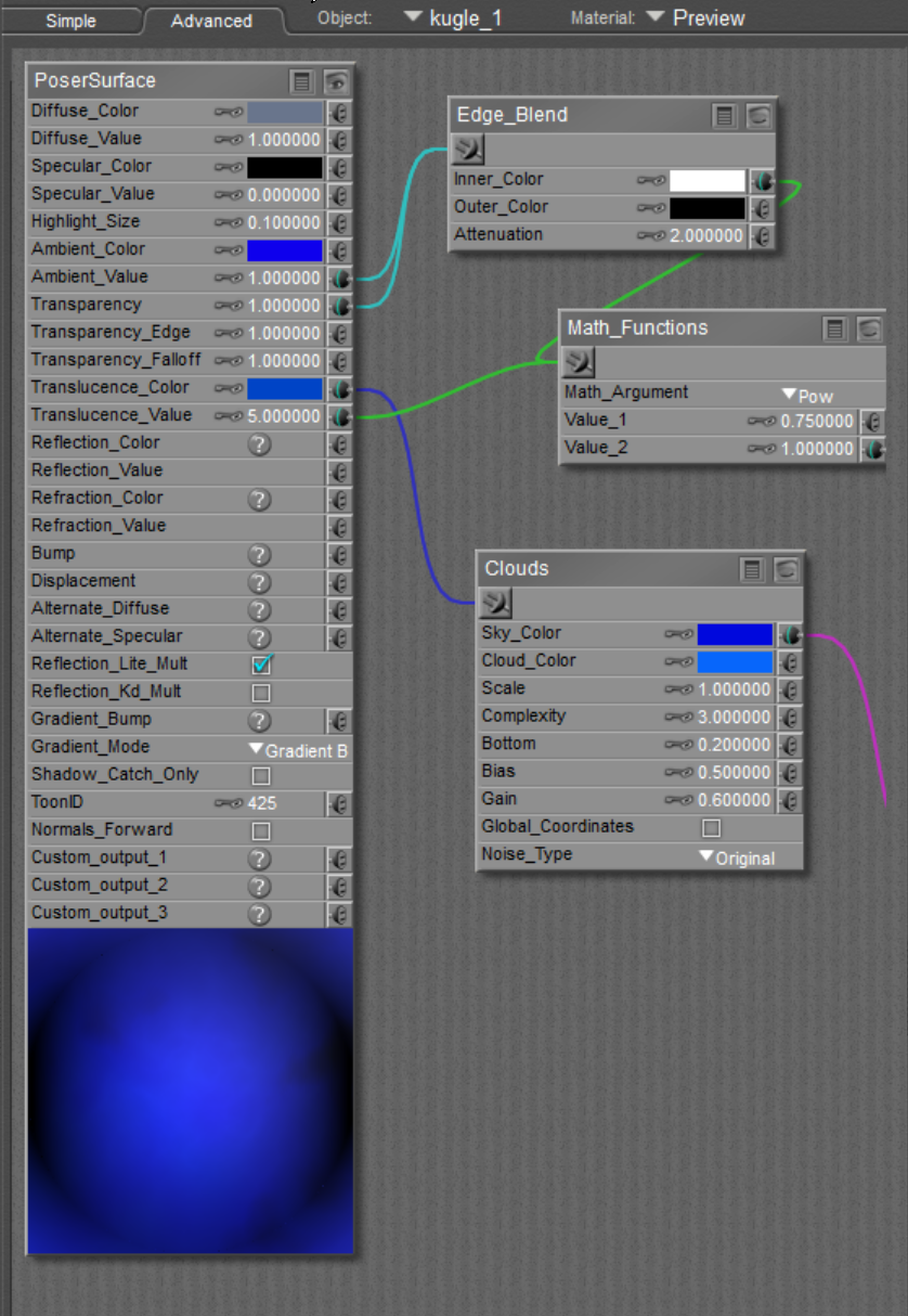

poser material nodes:
I'm trying to figure out why this is happening with some materials, while others (most of them, actually) transfer without any problem.

I think you might need a Diffuse material with an Emission.
