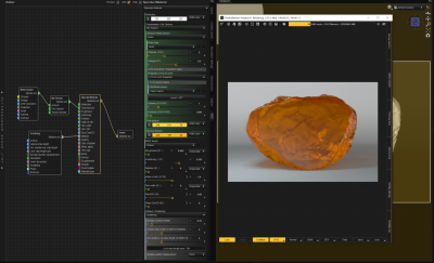

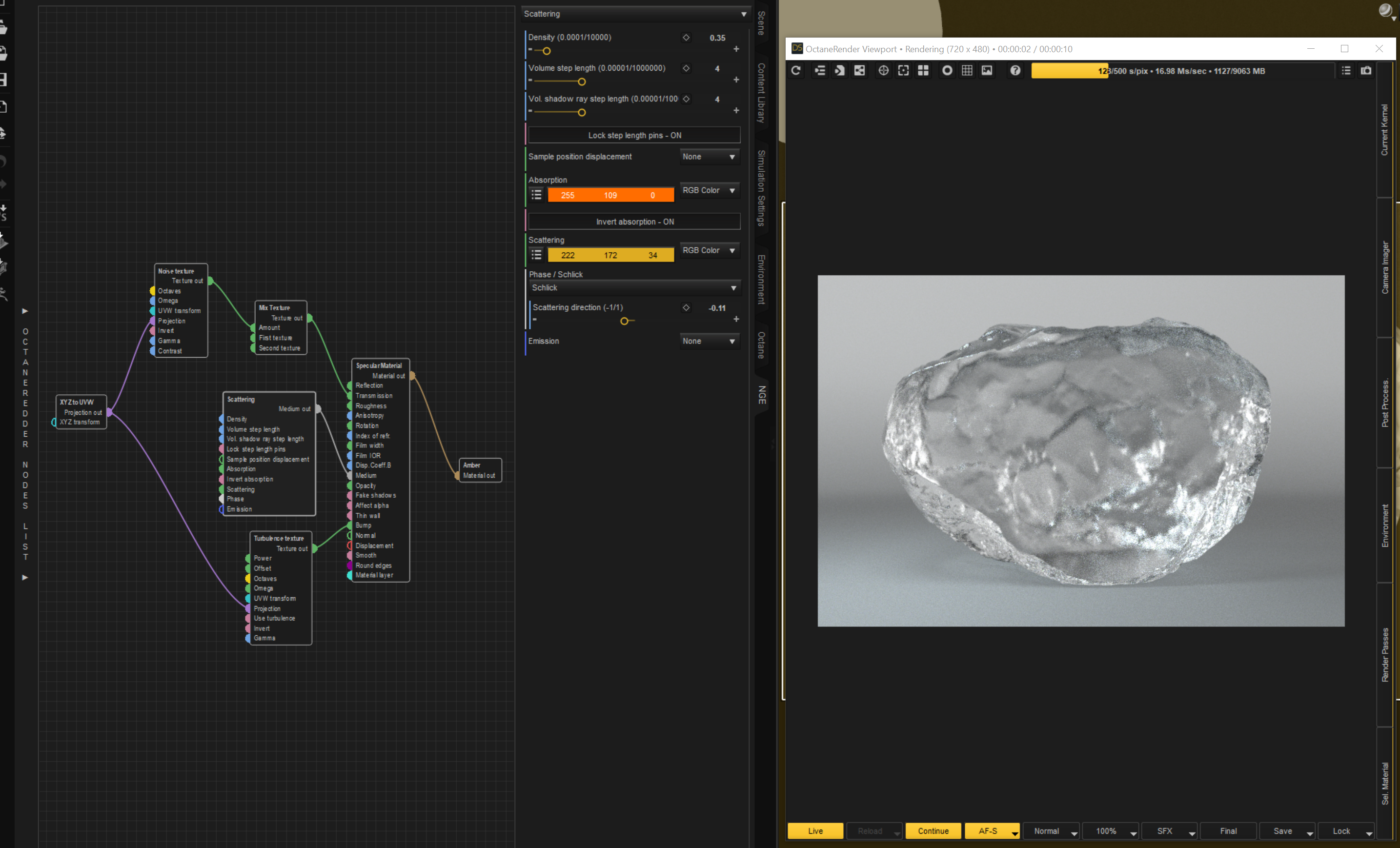

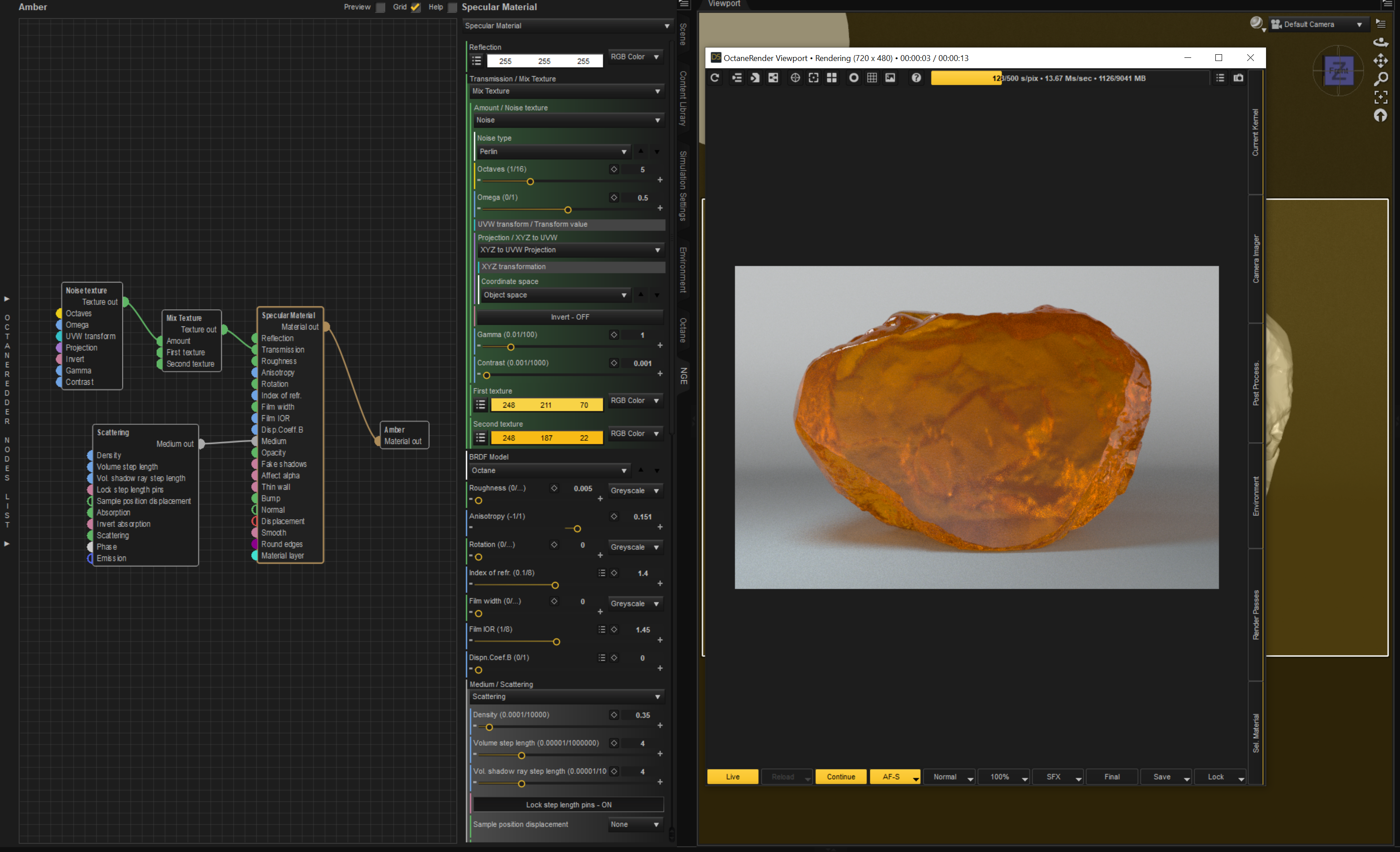

Hi Paul,
I seem to be having an issue using the Smart Unfold in NGE.
I've set up a Specular Material, added some additional functions.
Then when I use smart unfold, the settings remain consitent but I end up with a different render result. Please see screenshots. Any questions let me know.
Used smart unfold to get access to node but material changes.
The material set up, added some bump.
Hi. I couldn't reproduce this issue. Are you able to send me a scene with just that material (prior to the smart unfold) on a sphere please?
Paul

Hi Paul,
Certainly, please see attached
Amber.zip
(69.54 KiB) Downloaded 420 times
. Thank you.
face_off
Posts: 15797
Location: Adelaide, Australia
Hi Paul,
Thanks for providing the scene. Perhaps you could help here...to me it looks like unfolding a non-material node works OK, however when a material node is unfolded the result is a corrupted material, and the Amber Scene Surface can no longer be selected. I also notice that changing pins on the Mix texture doesn't restart the render, so there has been a break in the link between the Octane node in the NGE and the Octane node in the render engine.
Looking at the code, there is no obvious issue, and I suspect the issues around Smart Unfold have been there since the feature was added. My best guess is that fixing this would be a major undertaking.
I think the best solution is to disable the Smart Unfold option on Octane Material nodes.
Thoughts?
Paul
