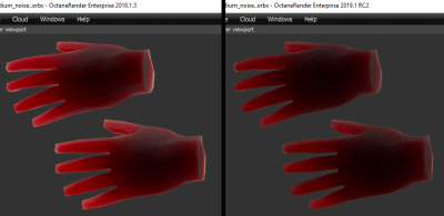

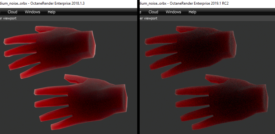

I have an old orbx which is rendering darker mediums in 2019.1 compared to 2018 and 4.
medium_darker.orbx
(141.79 KiB) Downloaded 309 times

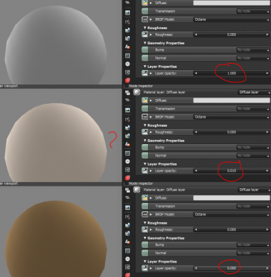

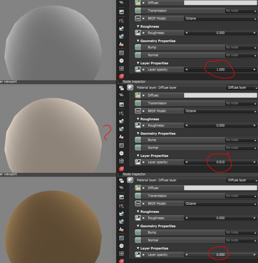

Layering bug? Diffuse material + diffuse layer opacity is not working as expected. (happens with other material layers too)
1. Load orbx and start render
2. Select the "test" material group and adjust the DIFFUSE LAYER opacity from 0 through to 1 slowly
When you go from 0 to 0.01, there is a drastic change from a darker color to a light one.

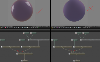

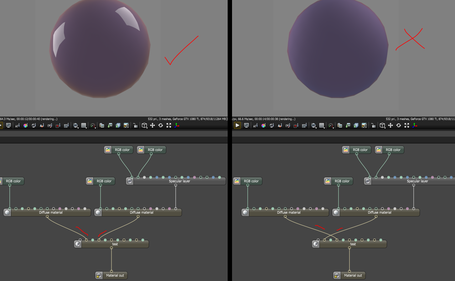

Composite/Layering bug?
I'm mixing 2 materials here with a 0.5 mask. If I swap the 2 material composite inputs, I should get exactly the same result, but I dont.
1. Double click the "test" nodegraph group
2. Swap the 2 composite inputs around

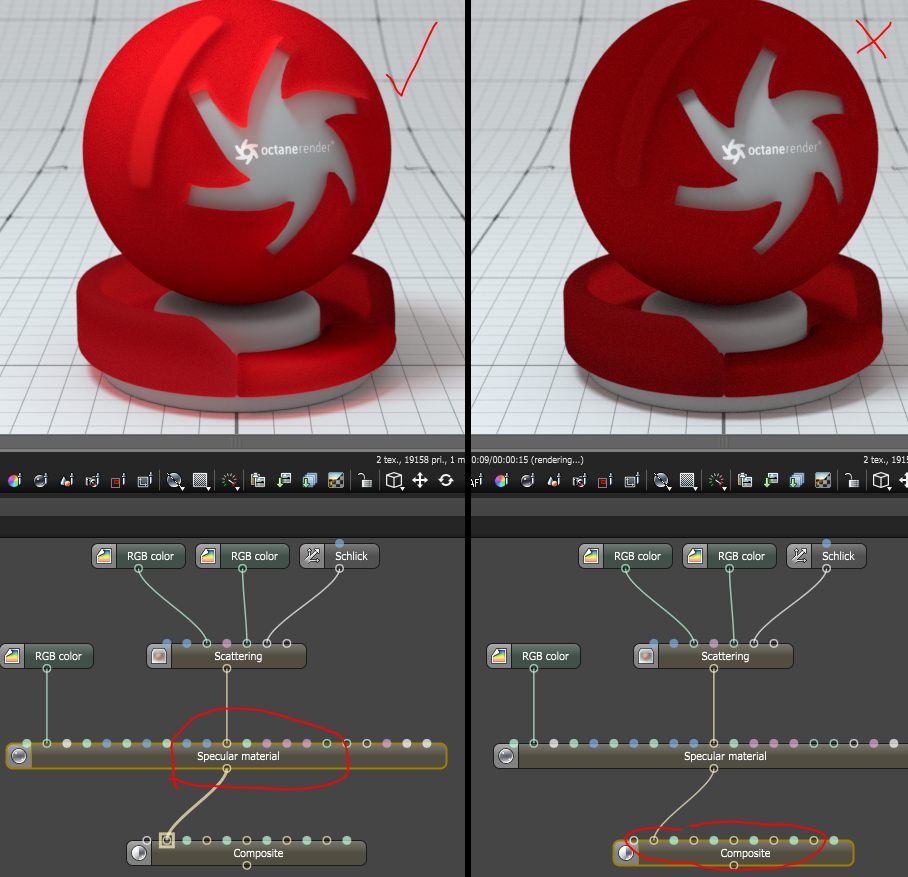

Composite / fake shadows bug?
Plugging this specular material into a composite, makes it darker. I think it's related to the specular fake shadows option
