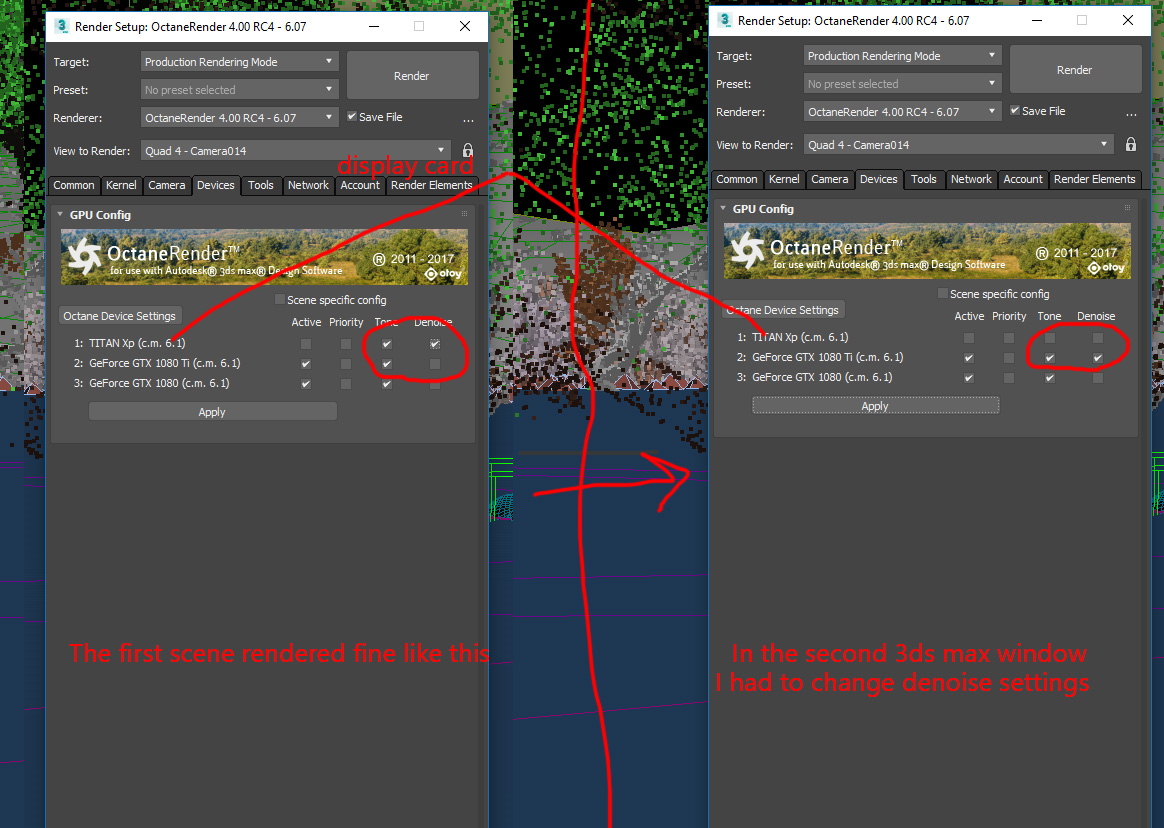

My GPU Failure ( out of memory ) happened this way:
I had 2 3ds max windows opened. After one 3ds max was done rendering I went to the second 3ds max window. There I went to the network rendering to steal slaves. After that I opened octane viewport to adjust brightness, etc. Once I started rendering on the second 3ds max window I got GPU failure during denosing stage. So I had to uncheck denoise from my display card and check denoise for rendering card. It seems that vram didnt get cleared on the denoising card therefore i got an error while rendering (or just a bug) I know it is a display card but it has 12 gb of vram plus the first 3ds max scene worked. Hopefully it helps.

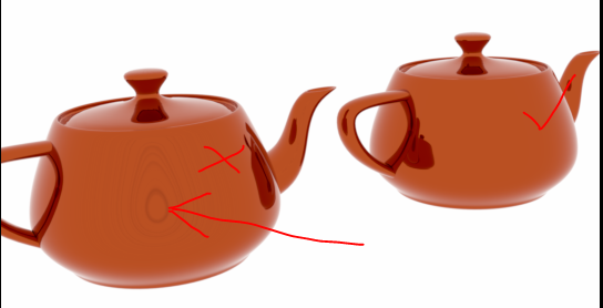

Universal with metallic set to 1 has reflection artifacts not seen in the metallic material
EDIT: Universal clearcoat seems to be affected by this too

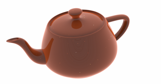

This combination of sheen + coat + ior causes fireflies and reflection artifacts
