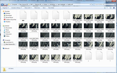

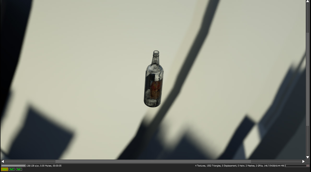

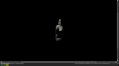

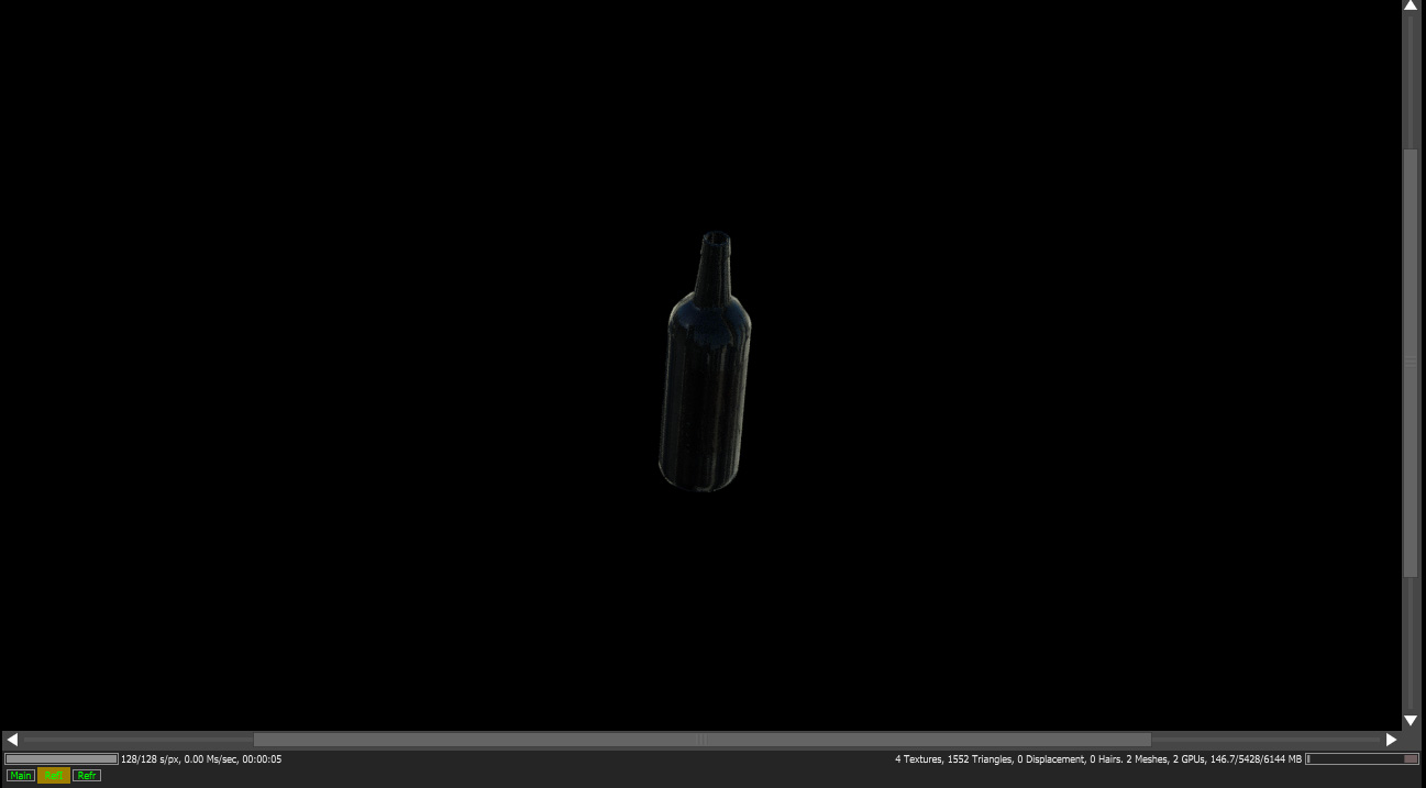

I'm trying the new animation script that is supposed to save all the render passes, however it doesn't work... :(
these are the passes as I see them in Octane:
Full frame
Reflections
Refractions
And this is what the script is saving out... :?
The files called "refractions" are actually the full frame ones, and then I have those weird files with letters, numbers and symbols... :?

I have the feeling the problem is in the Filename Template... At the moment is says frame_%f_%p.%e, If I change any of that, nothing is saved out...
I've also tried to rename those weird files into .png and they do have some of the render passes inside, but the script is obviously broken.
