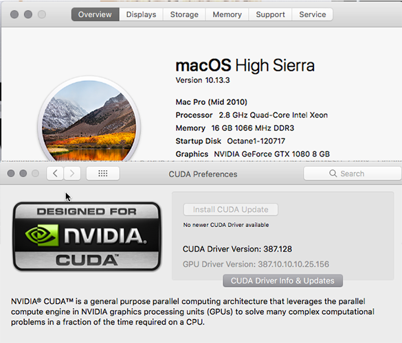

bepeg4d wrote:Hi,
I can confirm that 3.08 RC 2 and 3 works correctly on Mac with internal Nvidia or via eGPU, and you need to update both CUDA and GPU drivers to 387.xx, in both Sierra or High Sierra:
ciao Beppe
Thankyou so much! I was indeed confused as to driver versions.
Thanks also rrbarb for similar confirmation. I use a Mac Pro 2013 not the 2010/11 but still same same, really :D
Gonna jump on this today then and try it out!

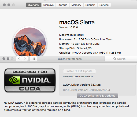

OP-1
rrbarb
Posts: 88
Joined: Wed Feb 26, 2014 1:40 am
macOS Sierra
CUDA = 387.128
GPU = 378.05.05.25f04
./rrb
