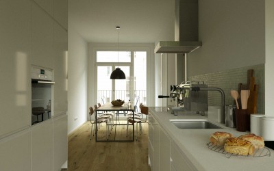

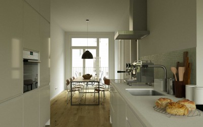

thanks for fixing the bump map issue with box projection.
I think I have found another issue with bump mapping.
The appearance of shiny materials with a bump map applied look quite different in 3.08 compared to 3.07.
Is this intentionally? When bump strength is set to 0 both look the same.
There's a lot of noise on the chairs on the right side, which didn't occur on 3.08 RC2
Render 3.07
Render 3.08 RC3

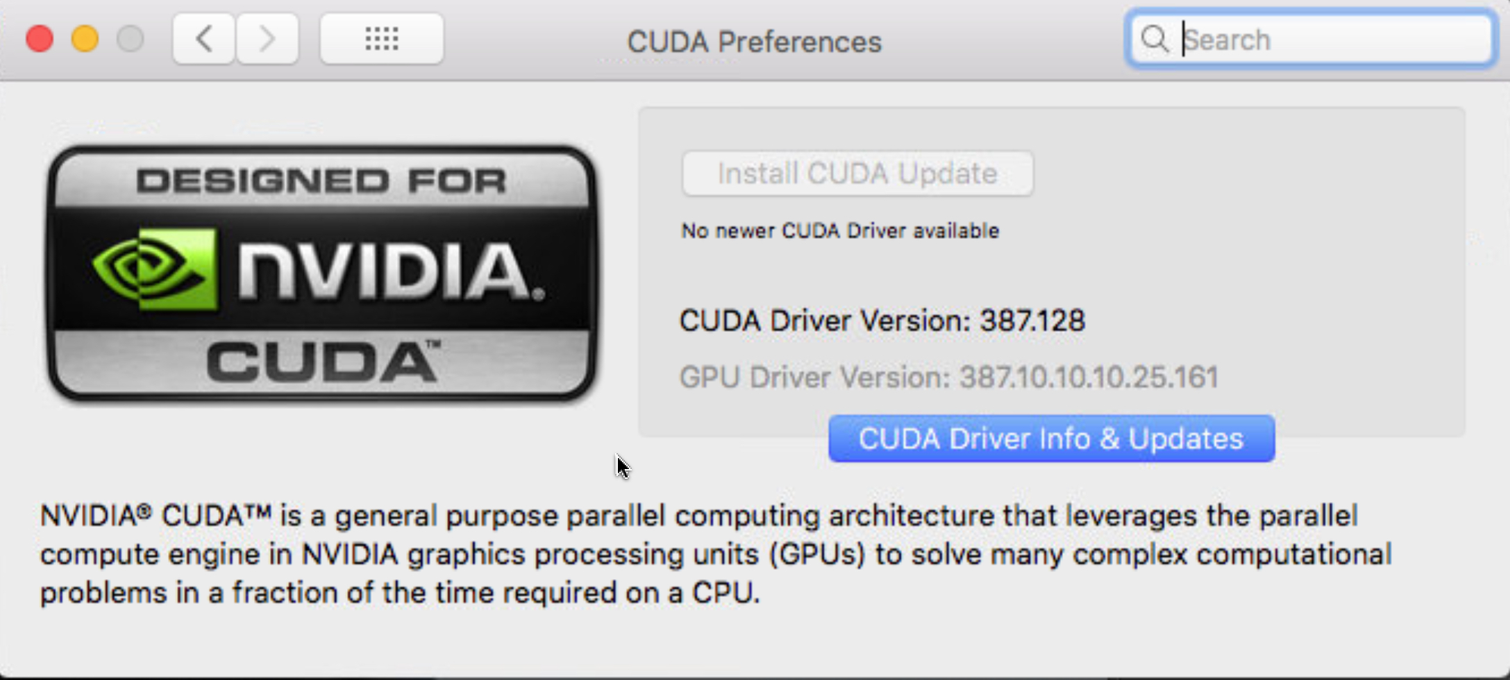

Posts: 10323
I can confirm that 3.08 RC 2 and 3 works correctly on Mac with internal Nvidia or via eGPU, and you need to update both CUDA and GPU drivers to 387.xx, in both Sierra or High Sierra:
ciao Beppe
