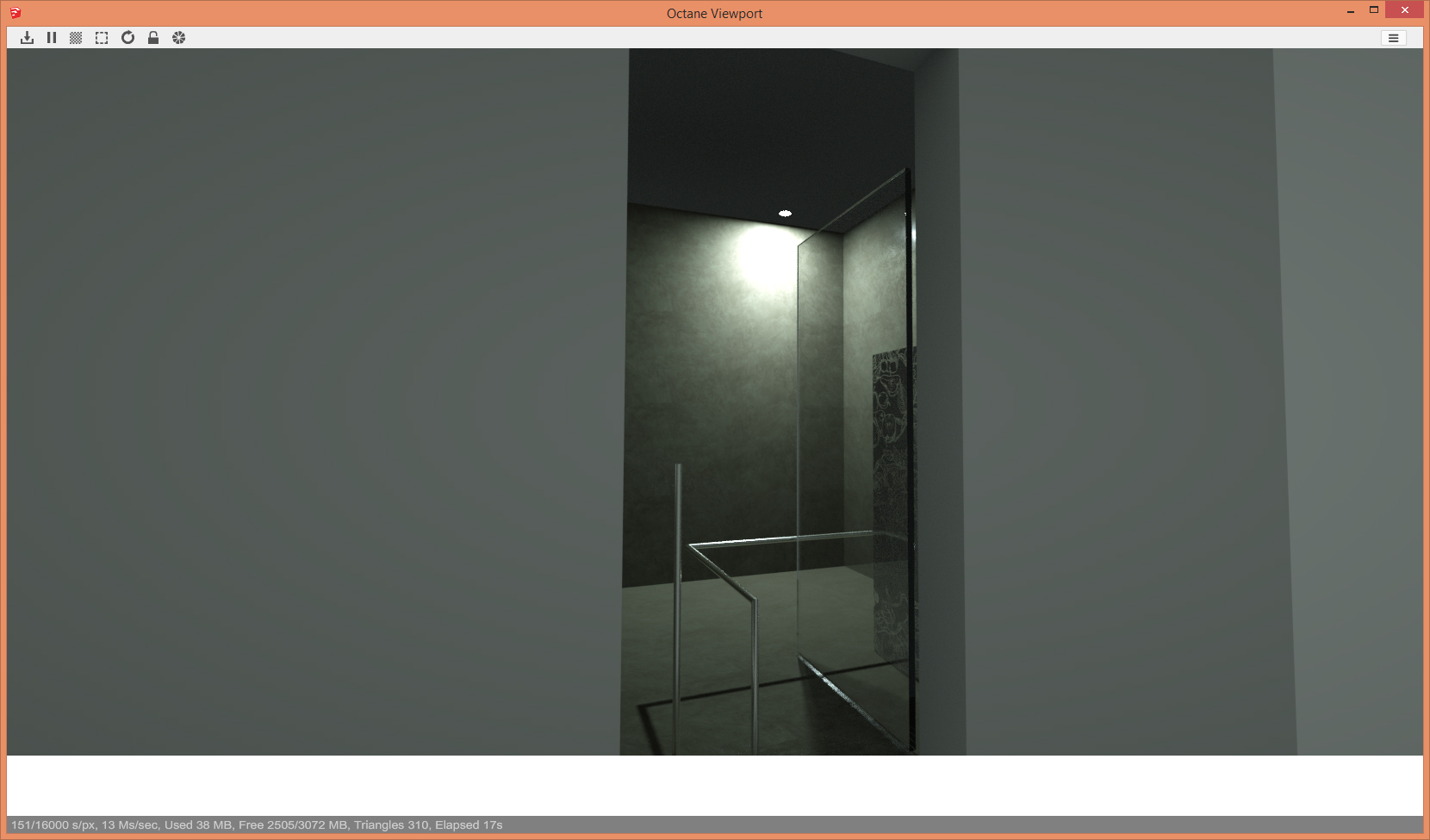

thank you perro_abombao for the reply,
I've tried the various settings and it seems to work,
a problem occurs when I save the file, close sketchup and re open the file: the renderer doesn't show the IES emission of the light source, as the material editor continues to show the parameters saved (blackbody emission, IES distribution,power, gamma, and all projection modifier)
I use octane Version: 0.13.82 in skp v14
mac
mac

To set the ies light to work you need to create a material in SU, with a texture applied, Ex: Light_ies1 with texture A("use a image texture" option in SU material editor), then you convert to Diffuse material in Octane material editor. Then you select the IES you want to distribution and all will work after closing and reopen the program.
it seems like the problem here is that IES is not a texture and SU with Octane plugin work with textures, so the bug must be here.
