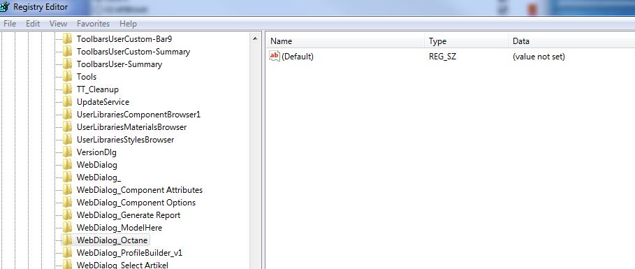

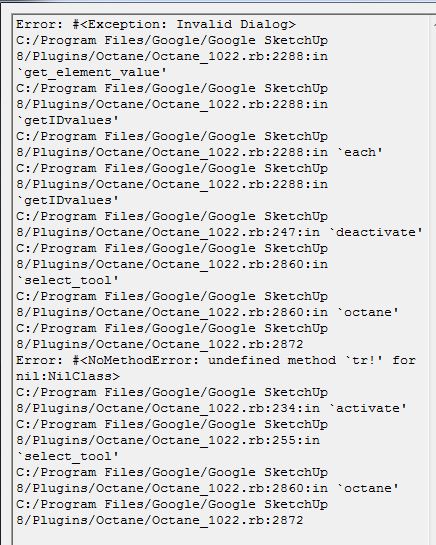

I tried it again and I get a longer error message than a few minutes ago:

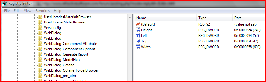

That all seems to be in order BUT you missed out the registry entries fro the Web-dialog it should look like this [Google > Sketchup 8]
I suspect it will look like this ?
try deleting that entry and trying SUp & the Exporter again...

This seams to be the problem
When i remove all the registry items and i restart sketchup and execute octane again. New registry items are build but still the size and position of the dialog are missing....

Guy
That Registry entry is now incomplete because the webdialog is failing to load completely - for some reason.
The long Console error-messages are simply a secondary result of the webdialog not being available...

Can you also check that the OctaneDialog.html file in the ../Plugins/Octane/ folder is the same in the v8 set as in the v7 [working] version, in case something is wrong there...
Can you also post the error message part about '...invalid dialog...' again...
