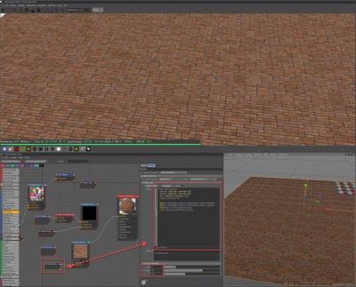

Posts: 16068
Location: Türkiye
Let me know this helps or not
textiler.rar
(2.57 MiB) Downloaded 484 times
Posts: 16068
Location: Türkiye
Another one

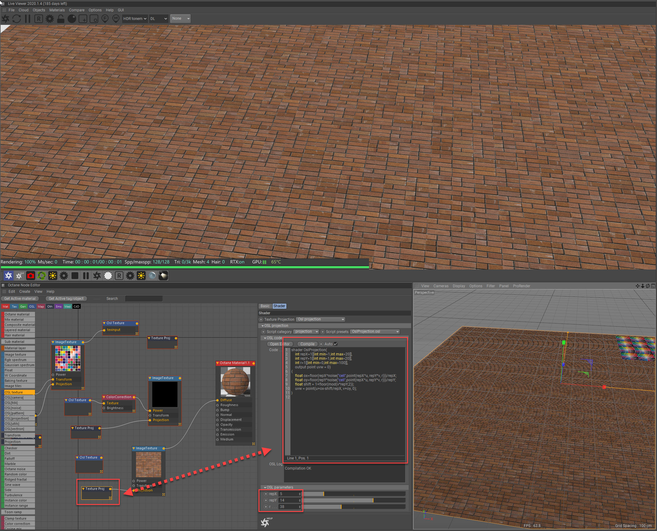

Hey so I'm struggeling with the second post - when I setup a Projection node with OSLProjection, it won't give me options to add parameters, only the code. Also, I copied the code in, letter by letter, checked 10 times that its identical, but still gives me a syntax error on line 7 (the float ox one).
What am I doing wrong? Any chacne to get the project file? But generally would also like to know how to add parameters to the OSL part.
Thanks Aoktar!
Posts: 16068
Location: Türkiye
Attached the project! Osl parameters need to be set as how much tiles have in texture for best results. Enjoy it!
