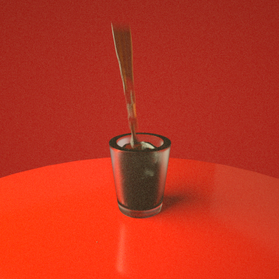

I am still having an issue with this. The vertex maps are working great with the Octane Object tab in vertex mode.
But at render time, the blur only renders if I render as a still.
When render is set to render still
If I render as a frame sequence, there is no motion blur. Any idea what is up with this?
When render is set to render animation
Posts: 16068
Location: Türkiye
What happens if you put a object tag to mesh or switch to "All movable" in render settings?
MontyVFX
Posts: 34
Joined: Mon Dec 19, 2016 11:49 pm
Yup that worked. Thank you!!!!
