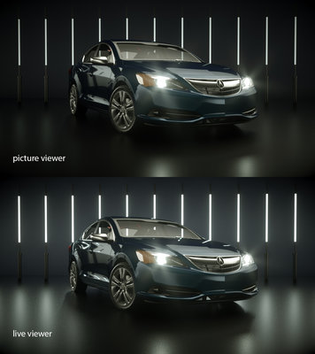

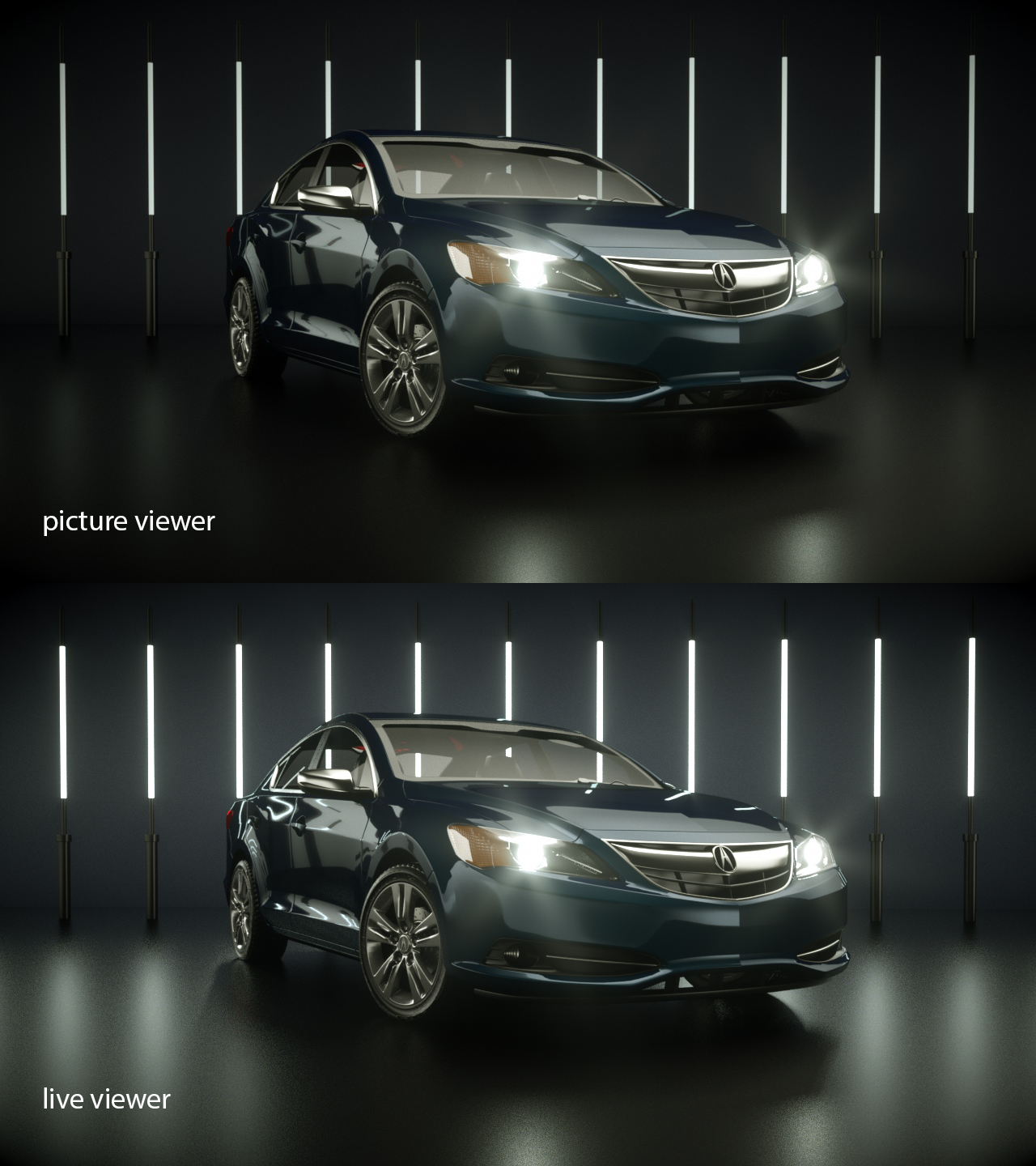

I am running into this issue randomly as I work with Octane. In some scene files it seems that I am getting a different result between the picture viewer and the live viewer. I'll attach the different renders, any help is appreciated.

is your light sources object or arealights? I see glows are different.

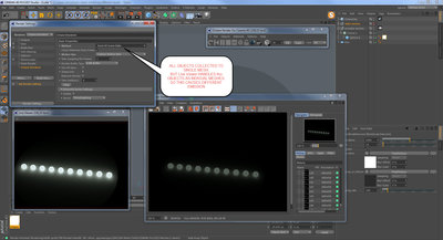

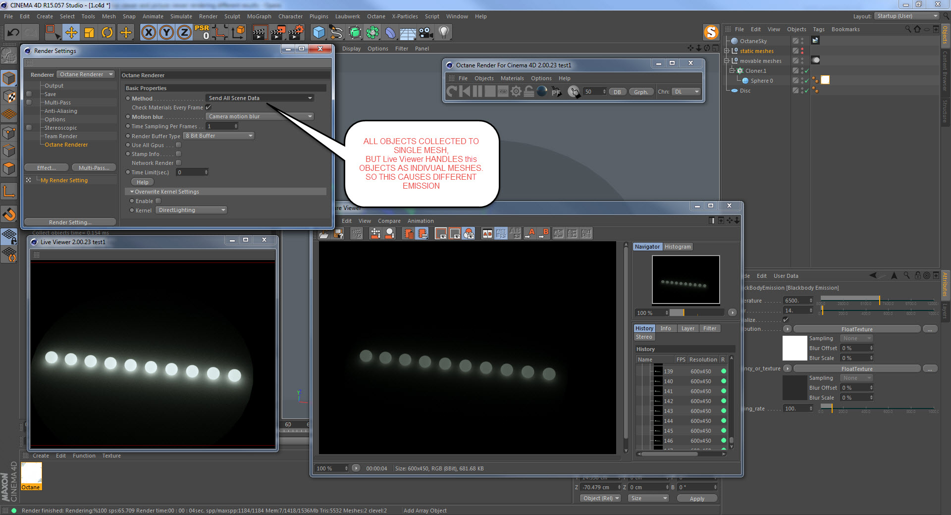

There is a issue for emissive materials. This works with some normalization over attached surfaces. If you have not a objecttag, all objects will collected to a single mesh. This causes some different illumination on different amount objects. But if you use a objecttag for this objects, every object will exported as indivual with some tranformation node. This provides exact illuminations as arealights

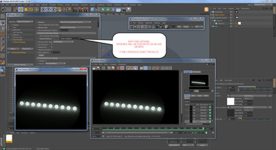

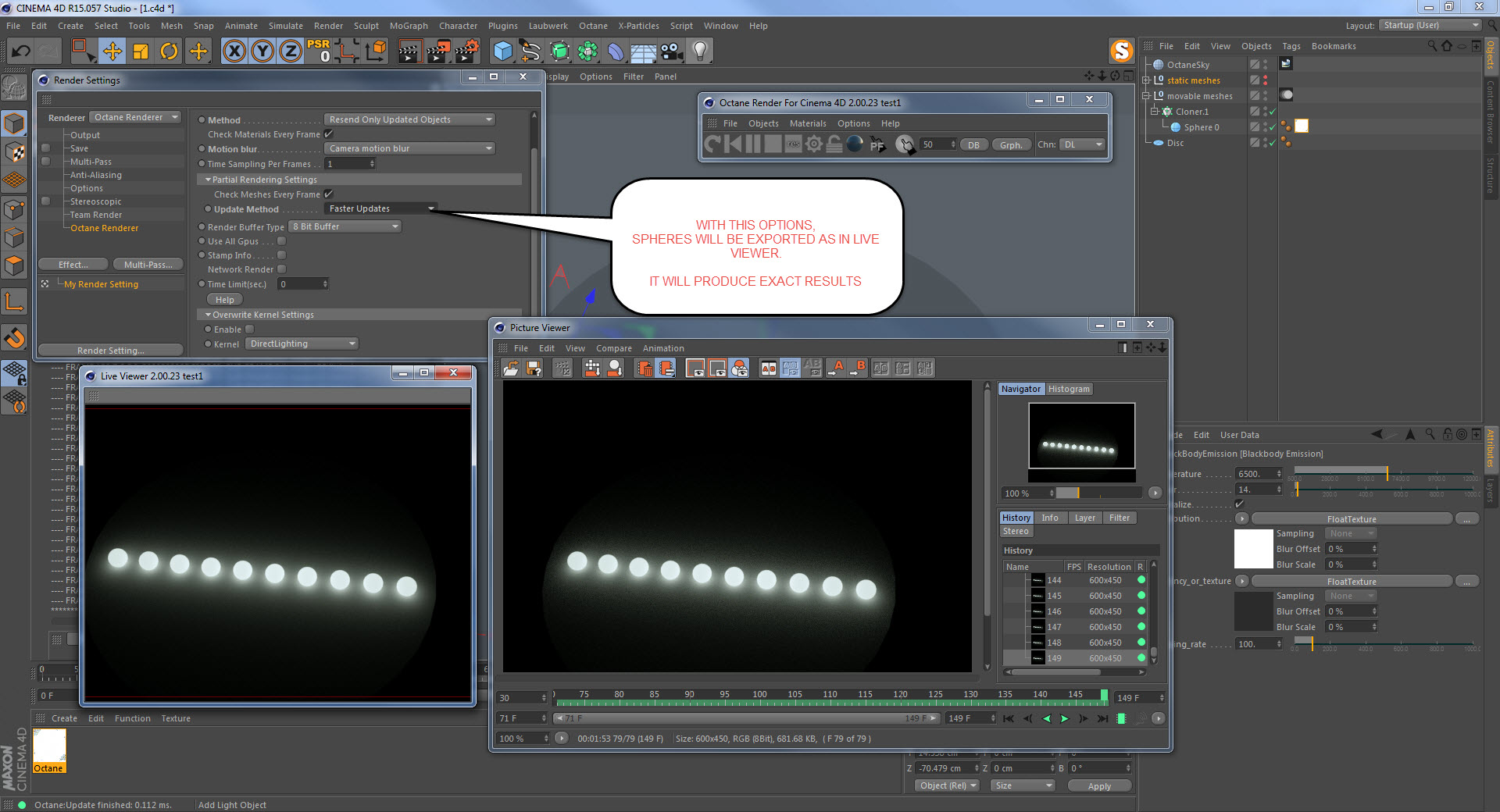

ok, solution is that:
choice method: Resend only updated objects
and
Update method: faster updates
This combination is exactly like as Live Viewer(interactive mode)
if you leave the "update method" as faster rendering, all objects in a same object no. They are collected to a single mesh in rendering. This causes different results.
