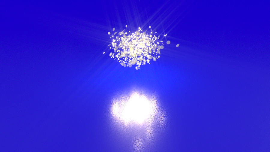

I have this render at 1000 samples, but the reflection is still noisy:
1000 samples
1000 samples

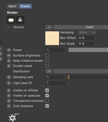

Aside from adaptive sampling etc, is there something I'm missing? I tried upping the sampling rate on the emission texture, but that doesn't seem to help:
emission texture settings

Hi there, proper sampling is primarily what should be correctly set, according to the scene. Light Sample Rate ≠ Light Samples.

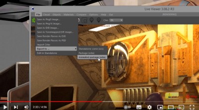

I thought it was possible to export to .orbx with c4d. :)
https://www.youtube.com/watch?v=zzlPI68RRW0 here it`s explained!

Ok I simplified it as much as possible, thanks!
test2.orbx
orbx
(64.86 KiB) Downloaded 102 times
render

Hello atoyuser1,
atoyuser1 wrote: thanks for the link, I had a read through it but couldn't see anything directly linked to my problem, but I will have another look
The information you are after is available in both my "article" and the official OTOY Octane documentation.
I have made some simple changes to the scene. Feel free to look into it, I have attached an ORBX file.
• I have made some subtle changes to the PT Kernel,
• I have changed the light's color node to GaussianSpectrum, being recommended in some cases (more information in the official documentation).
• For the sake of this test, I am using Filmic OCIO since having a display rendering transform is mandatory (https://www.elsksa.me/scientia/cgi-offl ... rvival-kit). It might render black. It can be set back to default, in the Camera Imager, or the Filmic OCIO can be loaded in the Octane's preferences, to match my scene 1:1.
• I am getting an acceptable result at 512 samples instead of 1000 and without a hardcore GI Clamping of 1. The Camera Imager's "Hot Pixel Removal" can be used at a "fair" value (ranging from .4 to .6 for instance).
I have limited myself to the original provided scene file. If that was me, I would have approached the scene differently (in regard to lighting, shading and "color management").
atoyuser1_light_color_sampling_elsksa.orbx
(52.73 KiB) Downloaded 92 times
