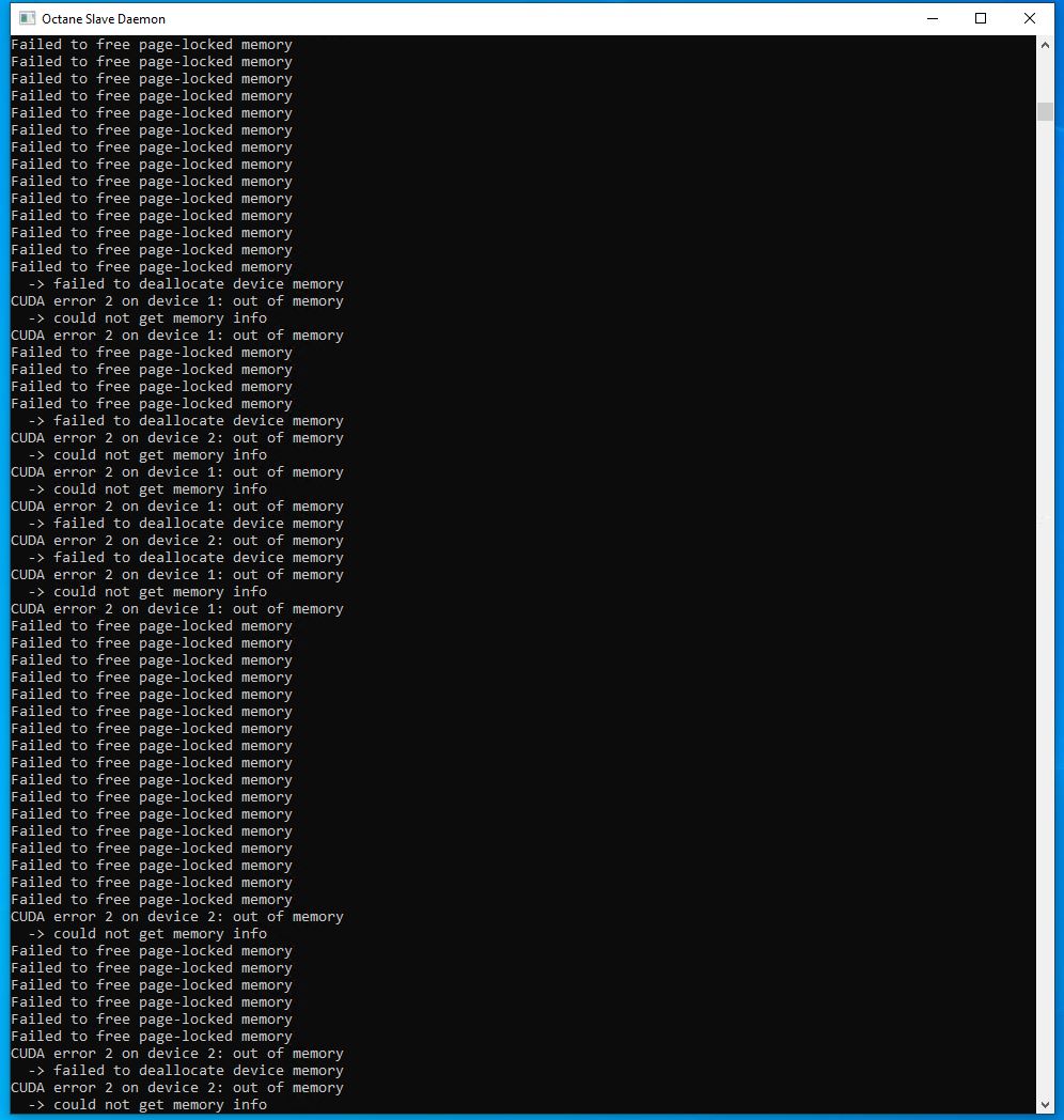

I'm having trouble with my slave render.
Any suggestions? I couldn't find anything about it.

**This only happens in scenes that reach out-of-core. Smaller scenes have no problem at all.

We had similar problem when we got memory error when we didn't have enough vram even though we enabled out-of-core. I think out-of-core only works with textures. Sometimes to much high poly mesh can cause this error like if you scatter itoo trees where each tree is 1 nil of polys.
I wonder if the error can also be cause where important large texture is split between vram and out-of-core or moved to ram and octane needs it cause the crash.

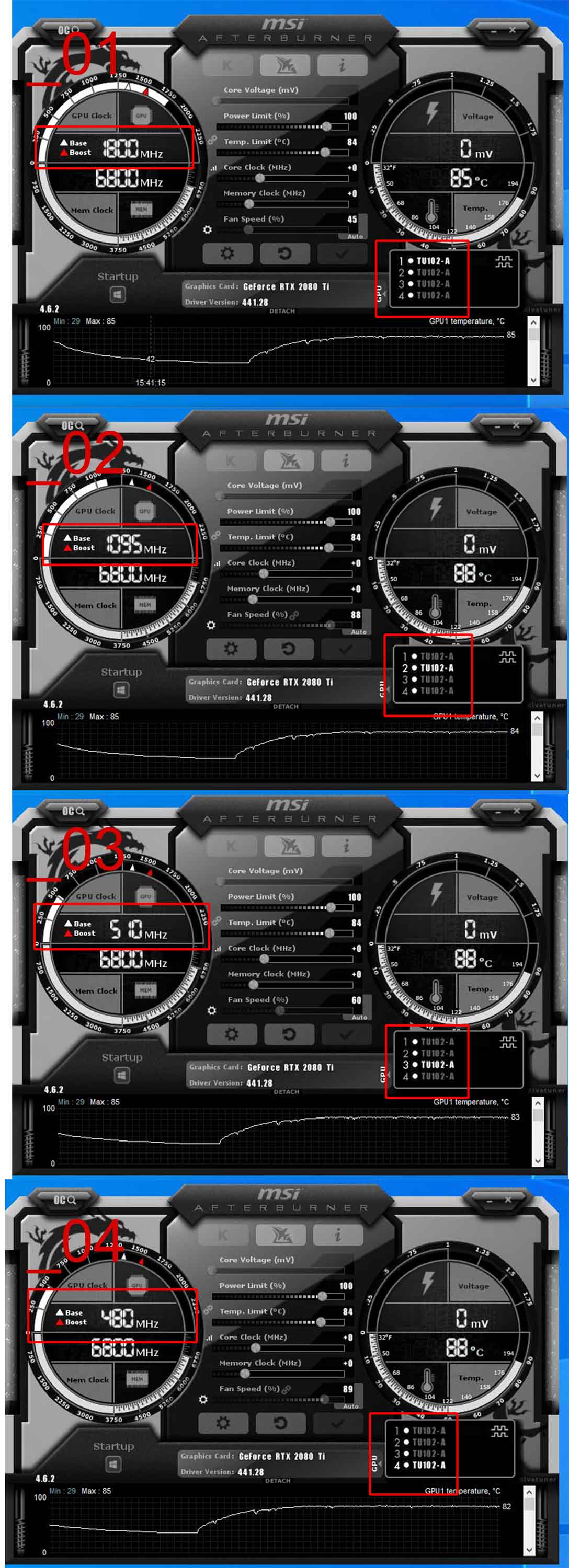

is this behavior normal? The frequencies are quite different.

Nothing has changed, the number one board is still working at maximum speed and the others are not.
this problem that you have seen before? is it something octane related or could it be problem harware?

samsue wrote:is this behavior normal? The frequencies are quite different.
According to what I could see, it seems that if the scene is not big enough, it ends up not using all the video cards.
