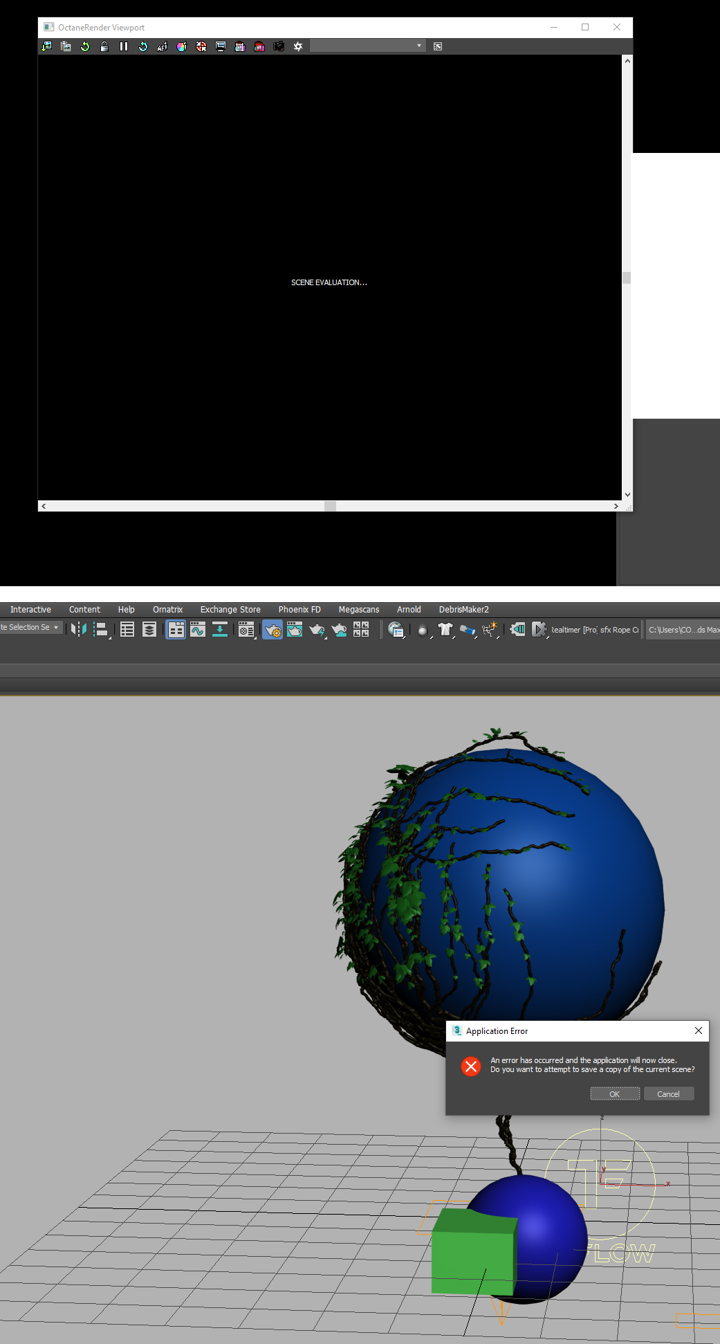

Anybody have tested last grow feature IVY in TYFLOW ?
All is ok with Tyflow, but when I try to use preset flow "Simple Ivy flow", it crash Max when octane render viewport open.

I will test it. I think octane get confused when new faces appear in real time while octane viewport is open

Hi, create a tyflow object, open tyflow window, Right click on window's empty area and choose "preset flow" then "Simple ivy flow" :-)

Yep. It crashes for me too. Can anyone look at the attached scene. I posted this problem on ty forum.

Hi coilbook,
Thank you for the scene.
This will be fixed in the next release.
