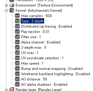

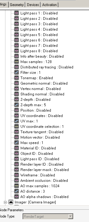

No z-depth min option here - see screenshots.
I think only needed options should be shown. It's confusing to see dozen of options that are not needed in current mode. At other software packages unusable options are hidden or greyed out. The Octane UI looks like made from engineers for engineers, who are testing a new great thing with hundred of knobs, and because it's quick build, there a lot of knobs without function in current mode. I think, for 3D artists the UI needs to be redone. I can live with the current UI, it's only a suggestion to make Octane more userfriendly.
