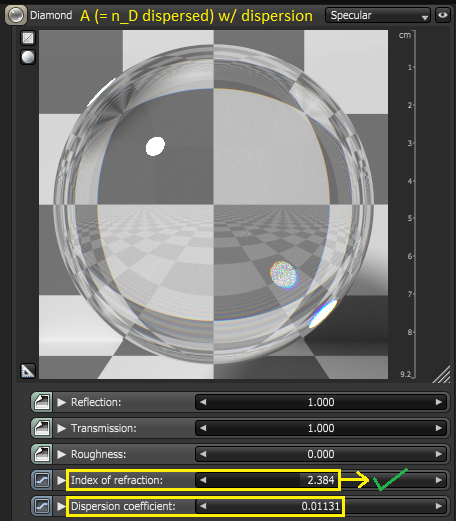

This conversion must enter "index of refraction" as n_D dispersion using Octane Render because you see the example of diamond material - 3 differences:
figure 1 - ior original w/o dispersion
figure 2 - ior original with dispersion -> incorrect because fig. 2 is different ior to fig. 1
figure 3 - ior dispersed (A) with dispersion -> correct because fig. 3 is as equal ior as fig. 1

After calculation, on Octane Render enter in specular material settings:
- "index of refraction" - 2.384 (= A = n_D_dispersed)
- "dispersion coefficient" - 0.01131
