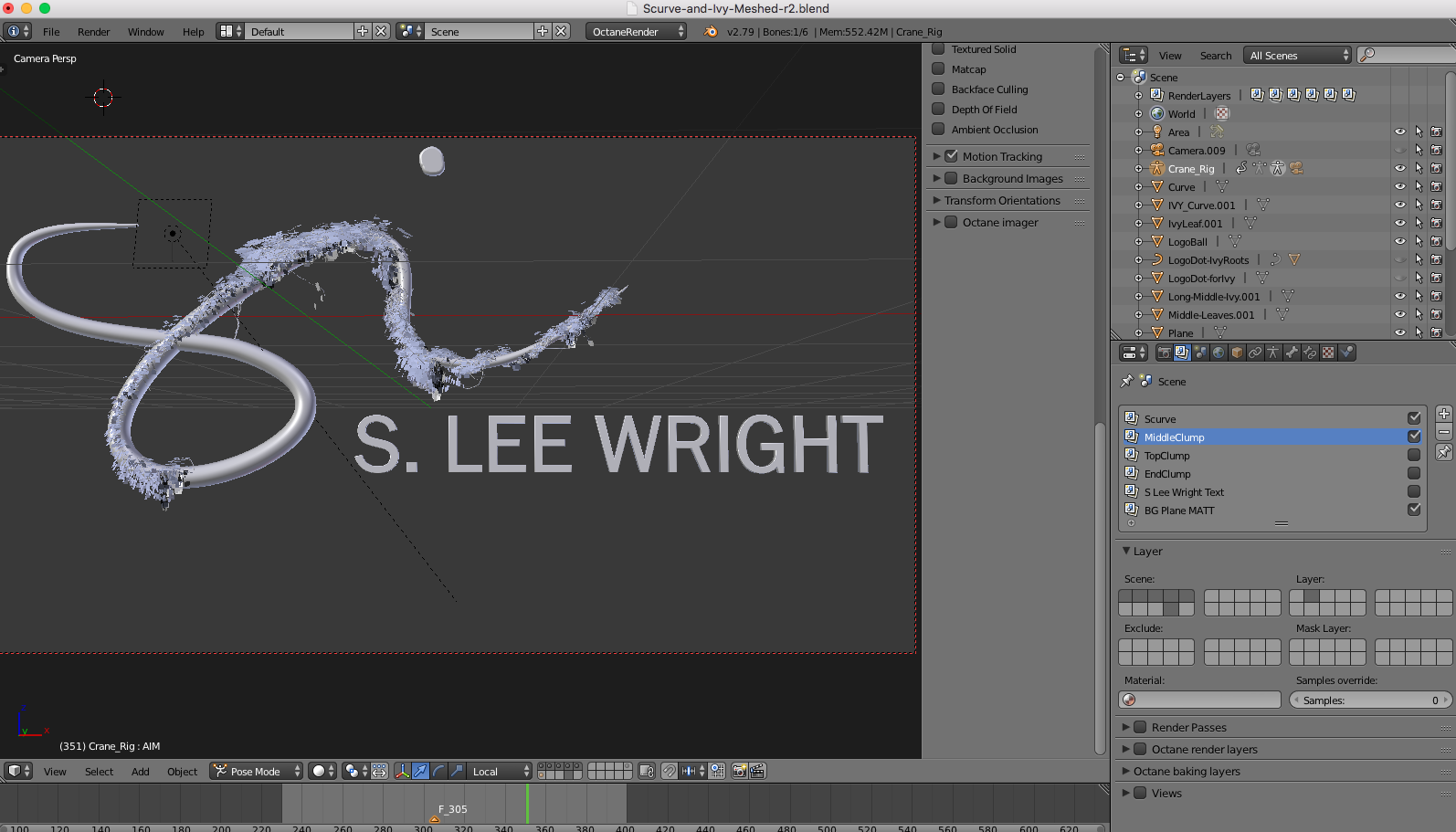

Hi. I sometimes make extensive use of Blender's layer system rather than Octane's render passes. See attached screen shot. This would break my project if Blender layers were hidden in Octane Blender. Maybe I am not understanding and this is a separate issue your discussing? But as you can see from my screenshot Blender layers work fine in Blender Octane plugin.

Hi pegot,
Thanks for your report.
We will investigate further about the cycle render layer in the next release. But for the coming 15.1(already in the final stage of test-release pipeline), we will keep it as hide by default.
You can turn it on as following if you want.
1. open "properties_render_layer.py" under "[BLENDER_FOLDER]\2.79\scripts\startup\bl_ui", e.g. for me, it is "C:\Program Files\BlenderOctane15.1\2.79\scripts\startup\bl_ui";
2. remove 62-64 lines and save
Code: Select all
        if rd.engine == 'octane':
            layout.label("Not available in the Octane Engine")
            return
Please backup the file before modifications. Sorry for the inconvenience.
