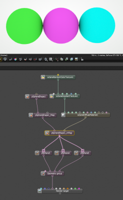

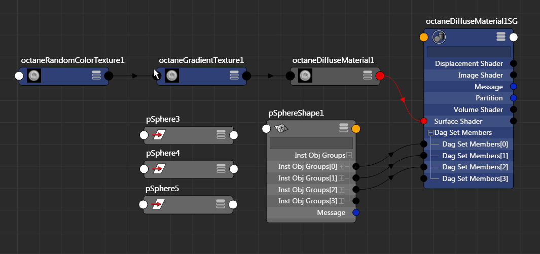

So each instance is connected to the same shading group in Maya:

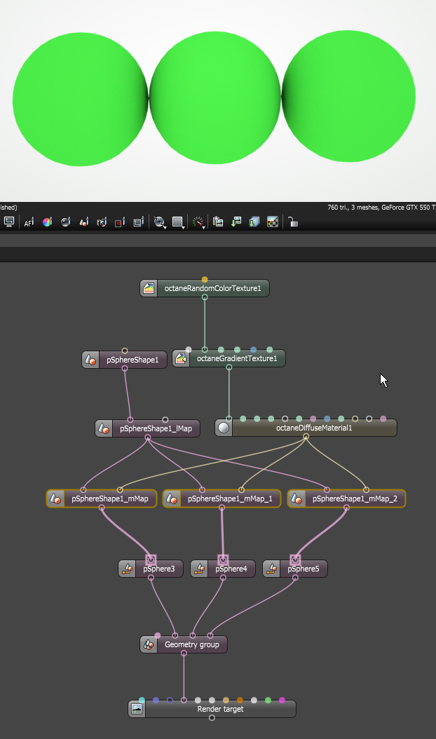

When exporting the scene as ORBX we can see in Standalone the problem and why the Bug happen:
instanceRandomColorBug.orbx
(98.1 KiB) Downloaded 372 times
The geometry instance is conected to 3 shaderMap but should only use one like this:
instanceRandomColorBugCorrected.orbx
(97.75 KiB) Downloaded 353 times
So to fix this bug : Instances using the same Shading Group in Maya must be exported to Octane as geometry using the same Material Map node.
(but obviously Maya instance with different shading group still need different Material Map node)
