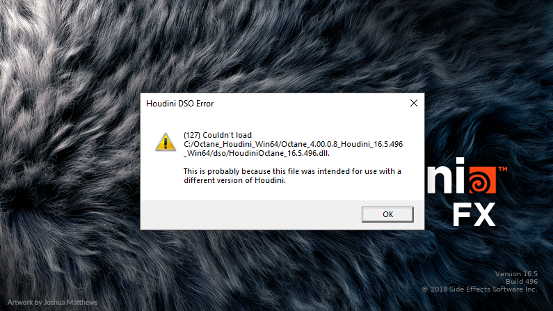

I can‘t add Octane in out, and Octane 3.08.1.0 is worked fine.
i add this in houdini.env
Code: Select all
PATH = "$PATH;C:/Octane_Houdini_Win64/Octane_4.00.0.8_Houdini_16.5.496_Win64/bin"
HOUDINI_PATH = "C:/Octane_Houdini_Win64/Octane_4.00.0.8_Houdini_16.5.496_Win64;&"

Weird, I've just installed the released .496 version from the .zip file in your same folder and using your same houdini.env configuration and here all works fine. Do you have the
Code: Select all
HOUDINI_DSO_ERROR = 2
variable defined in your houdini.env file?

Postby David_DK » Wed Jul 04, 2018 1:10 am
David_DK Wed Jul 04, 2018 1:10 am
thanks again.
I add 'HOUDINI_DSO_ERROR = 2' to houdini.env file. and says that.

You can also replace the $PATH position in the PATH variable ... try this one:
Code: Select all
PATH = "C:/Octane_Houdini_Win64/Octane_4.00.0.8_Houdini_16.5.496_Win64/bin;$PATH"

Postby David_DK » Thu Jul 05, 2018 1:07 am
David_DK Thu Jul 05, 2018 1:07 am
I replace the $PATH position and it's worked! Thank you so much!
