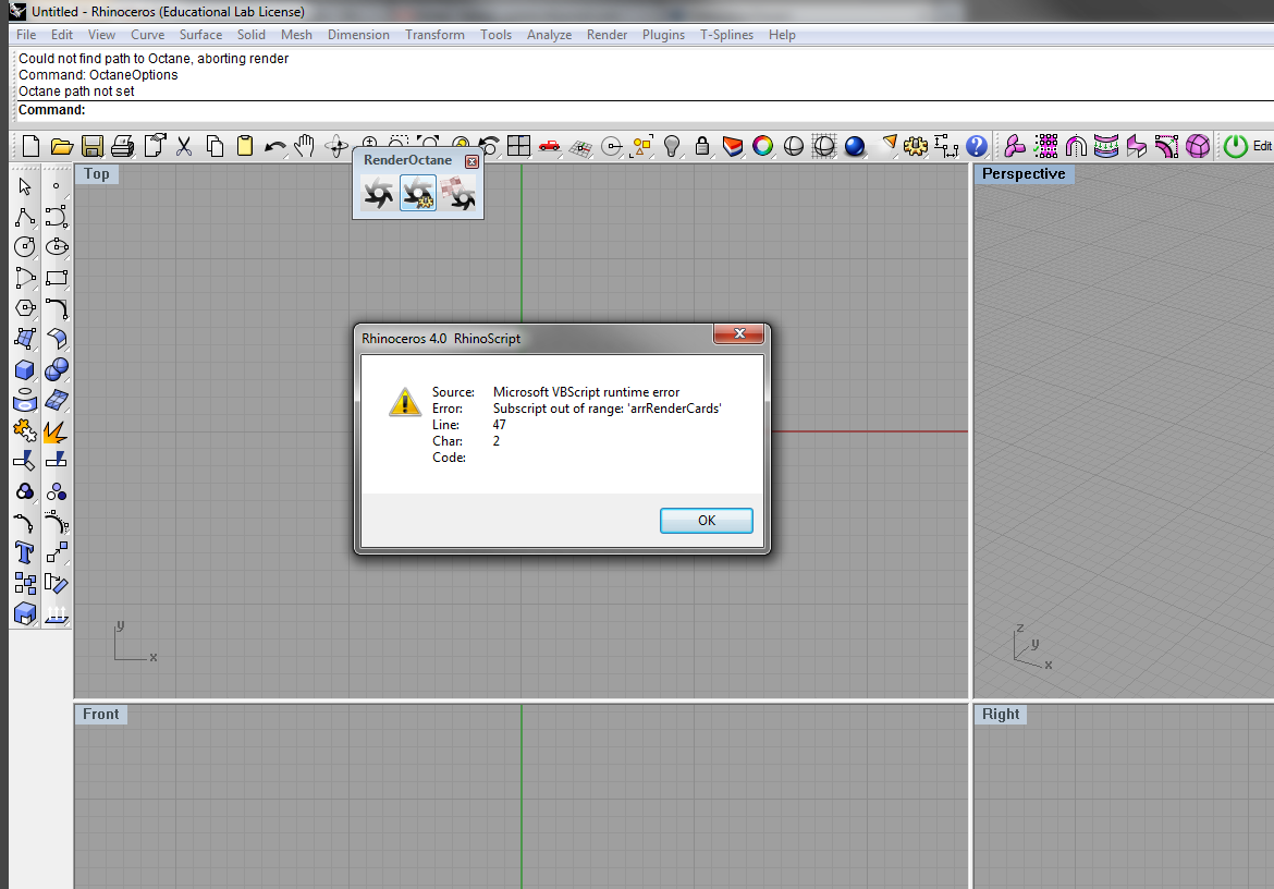

I have this error coming..
Can you check the plugin again ?
Best Regards, Jitendra

Mmm, lovely. How many video cards do you have in the machine you are getting this error on?
Also, can you look to see if you have this file:
Win7 / Vista:
C:\Users\[User]\AppData\Roaming\OctaneExport\exportOptions.ini
Win XP:
C:\Documents and Settings\{user}\Application Data \OctaneExport\exportOptions.ini
If you do, can you post the contents?

I am running with two graphics cards.
GTX 470 + GTX 580.
There is no file under C:\Users\[user]\AppData\Roaming\OctaneExport
Thanks.
I am using Rhino4 SR9.

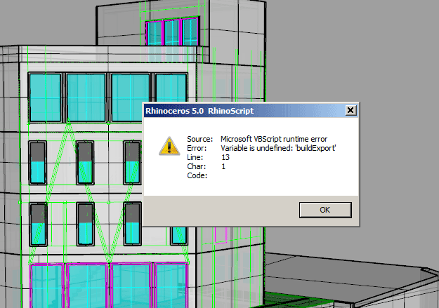

Hi Sam, i get this strange Error in V5, exportOptions.ini looks like this:
Path=C:\Program Files\Refractive Software\OctaneRender 1.025 beta2.52\Octane.exe
nSamples=0
bRenderOnStart=True
card=;False
bCamTilt=False
any idea?
thanks for your great work! Steffen

SamPage
Posts: 132
Joined: Mon May 10, 2010 8:56 pm
Location: Burbank, CA
Sorry for the lack of replies. It is looking like the errora are cropping up in the VBscripting engine itself. McNeel is still trying to hammer this one out. The obvious solution is to rewrite it using a different language, which should probably be done, it is just a mater of finding the time at the moment.
Sam
