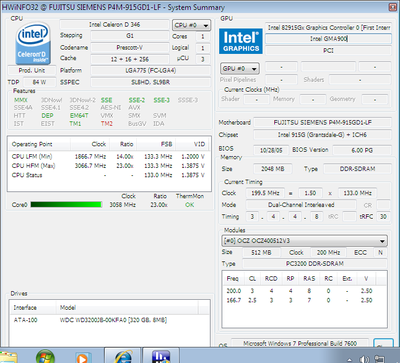

I've attached a screenshot of my system info (with only the on-board graphics enabled) and its showing an intel chipset for the graphics but there must be another issue somewhere
Many thanks for your help on this anyway.
cheers
