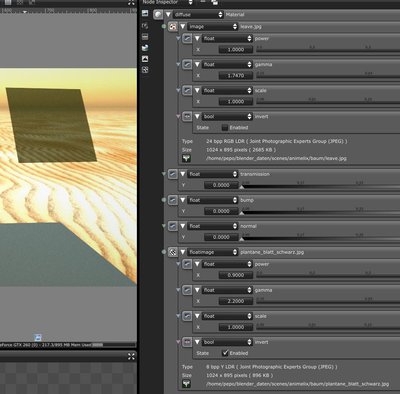

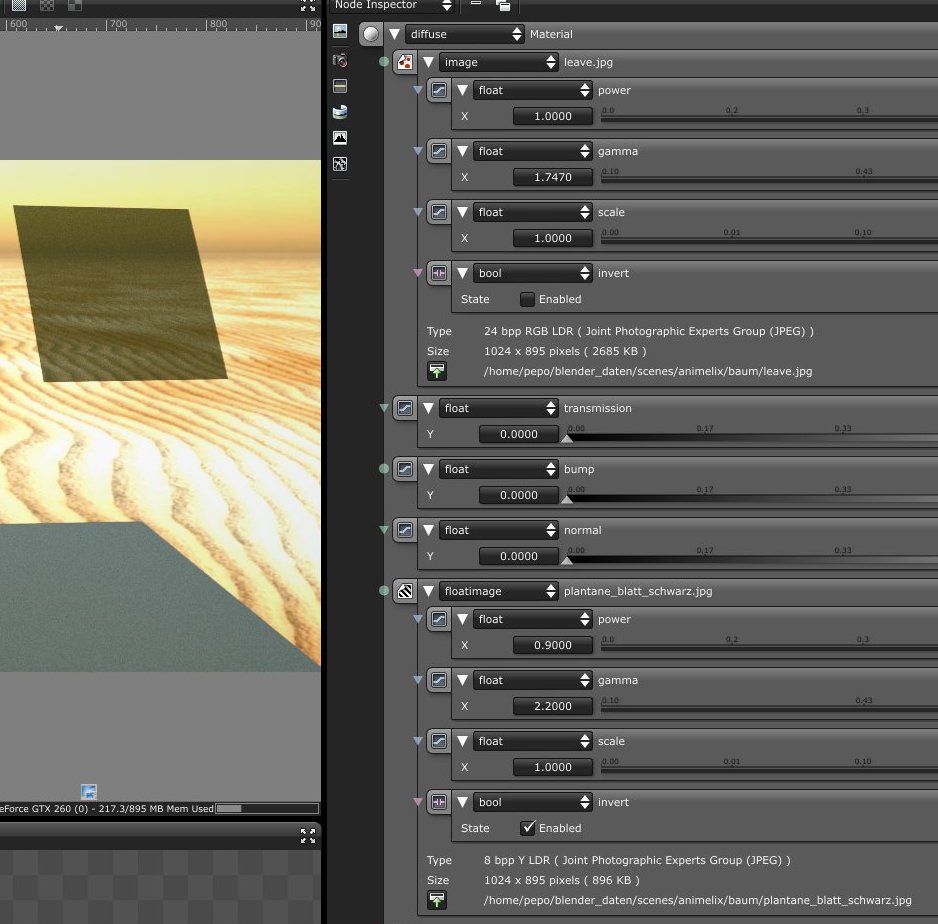

First, i can't get it to work. What i now/have, alpha maps don't work with sunlight and I'll should put a floatimage
in the opacity slot.
These are my diffuse and alpha maps:
Any help is welcome, mib

I don't understand your question.

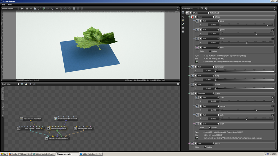

just make a material, stick the diffuse map on the diffuse slot as a 'image texture' and stick the opacity map in the opacity slot as a 'floatimage'. use invert option if needed to switch the white/black for the opacity.
it should work just like that.

Sun doesn't cast shadow based on alpha but that was reported 15 min after beta2 was released! :) So other than that you should check your system!

This is what i do the last hours :) , but don't work for me.

oh linux.... can't help with that! But one thing I notice... if you want to 'clip' the geometry thru alpha you need to put the power in 1.0 instead of the default 0.9. That was giving me strange results with the default value (ie little transparent all over the leaf)

Thanks, I screw on all possible faders but the plane goes only more or less visible.
