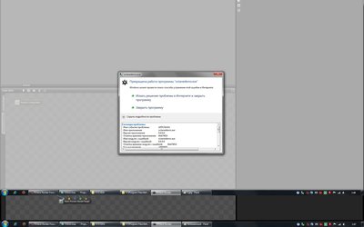

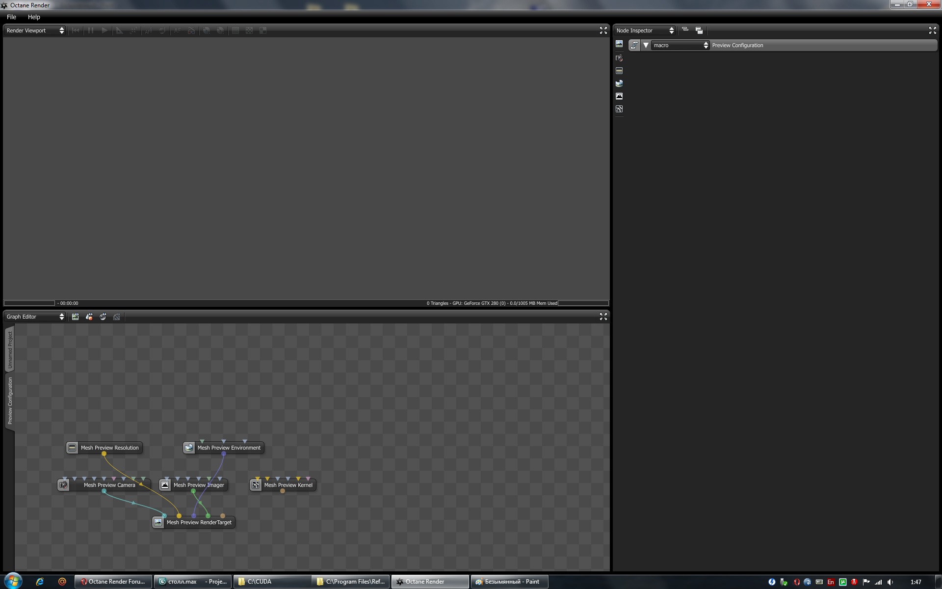

Hello.I downloaded all the versions of your software,installed all versions of CUDA drivers.Your program does not work. It starts, a window opens, but I do not see the render. In the settings of video card and CUDA determined.When I load OBJ file in your program just closes with an error. My configuration: Win7 x64 Q6600 6GB RAM GeForce 280GTX. What is the problem? Help.

all you need to install is the correct drivers, as specified in the readme file.vano1986 wrote:Application crash even if i change resolution,delete node,change HDR texture etc. It doesnt work. Maybe I need install something for windows?
Radiance
you should try with a simple object, like a cube.vano1986 wrote:I understand, you cant help me.
if that does'nt work, either you have the wrong drivers installed or your OS or hardware is damaged.
Radiance
It is possible you have the same problem that i had.
Download Driversweeper and remove anything related to Nvidia on your computer. Reinstall the devdrivers and it should work. You dont need the cudatoolkit.
