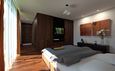

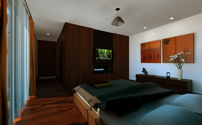

Hello Octane friends,
I wanted to try Octane so i bought my own comercial licence, this is my first render with Octane, so far i am liking the software a lot but i havent got the realistic results i would like... (most of my renderings look like my old Mental ray renderings) i thought that a unbiased renderer would improve that a lot...
i know there is a long way of learning to get photorealistic images but i would like to get there some day.
I hope you guys have the time to give me some advices and say what you think of the image.
thanks :)
Also some questions :)
-isnt 7 hours to much time for a render of this scene? is there a way to optimize this?
-Why is the diffuse option of the DL Kernel so slow as it is supposed to be biased? (i say this because the image needs i think 2 more hours to clean, so i better use PT or PMT)
DL Kernel (AO), rendered 1x times the final resolution, 5 min.
DL Kernel (Diffuse option), rendered 2x times the final resolution, 30 min.
PMT Kernel, rendered 4x times the final resolution, 7 hours.
System: Windows 7 64 | GPU: GTX 580 1.5Gb | CPU: Intel Core i7 2.8 Ghz | RAM: 4GB

Im no expert but maybe light passing thru those curtains is your main resson for long rendering time.
Agree with you, doesnt have that wow factor.

Hi, thank for your post, do you know which material is better and faster for this curtains, i used diffuse mat with transparency.

Sorry not a Octane user :oops: , yet, but I recommend try rendering scenes without curtains, and with window portals...No glass on windows

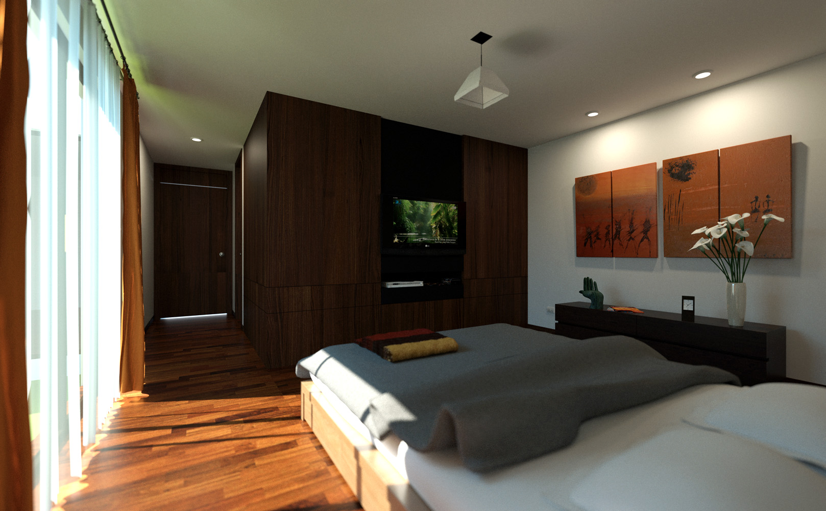

Well, i tried a little editing in photoshop, i think it looks a bit better...

you should remove the focus makes the scene look like minature model.
make textures for the bed cloth and pull it into sculptris and make wrinkles.
try care for small model details and correct texture scales

GK is spot on , there is nothing wrong with the light ,work on the materials , the floor for example needs some bump map
dont remove window glass or walls to get light in like some people advice ,if Archviz is what you do ,your client wan't see a image of there future home
that is faked by removing stuff that need to be there. for the first render it is very good
keep up the good work

Thank you very much for taking time to give the recomendations, and i agree with what you say about faking things... i dont like it neither.
i will work with the details of the scene you mentioned and post the work.
i will not change anything but the details, textures,etc (i will leave the camera, ilumination, etc) to check how it improves.
