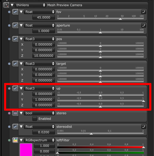

I have a head in Octane that is defaulting to a frontal view. I want to revolve around to the side of it so that I can render its profile.
However, using a three-button mouse I can only tilt the head from side to side or orbit over the top of the head to the back. I can get around to the side but then the view is on its side with the model is on its face (looking straight down). In 3DS Max I can hold Ctrl key to orbit to the side but in Octane Ctrl just moves the whole view around inside its frame (I'm not sure what the benefit of this is).
Can someone please tell me how I do this?

Tweak this vector parameters, when your camera "falls to the side", to straighten it up: There are no ways (that I know of) to lock rotation axes or somewhat constrain the cam rotation to an axis

Thank you Matej!
Using your directions I was able to tilt it back to the horizontal.

Yes and a real free 360 degrees navigation with the mouse, so you can reach any point or orientation with your mouse only. Maybe also a way to shift the rotation center from the current focal point to the camera center and back, so you can rotate in world space & camera local space. And a way to constrain rotation to a single axis (in global & local space)...buggy wrote:Refractive ought to add a key-mouse combination so we can revolve the camera around the focal point on the vertical axis without having to play with the camera settings.
