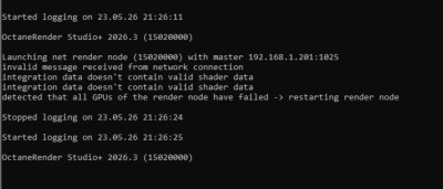

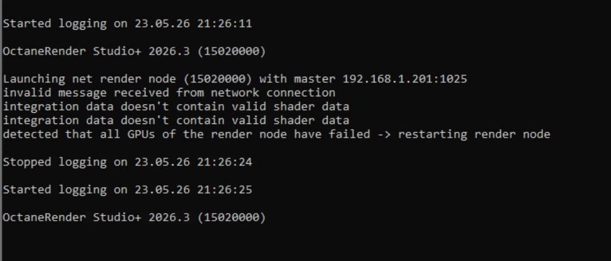

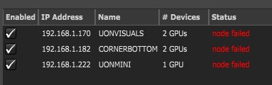

Network rendering isn't working on any of my nodes, what does this mean?

Do you Vectron objects in your scene?
Vectron is giving those error messages on Render-Nodes 2026.3.
It has been already reported to core devs and should be fixed for next Octane core update.
ciao,
Beppe

Yep it's a vectron scene, I'll wait for the next version then!
