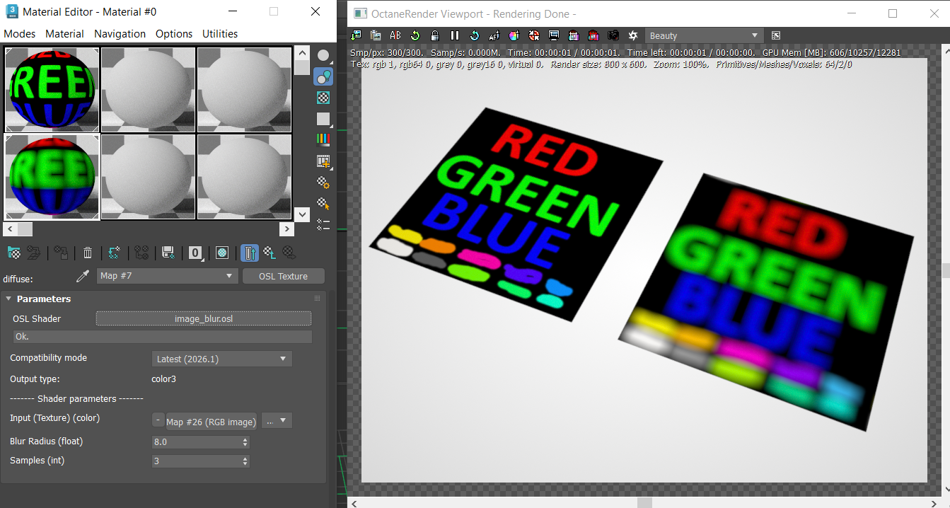

For the blur, there is no such node in Octane for now, so I made a simple OSL texture:
The only thing to remember, is to set the UV projection as 'OSL delayed UV', or else it won't work.
image_blur.zip
(148.25 KiB) Downloaded 48 times
