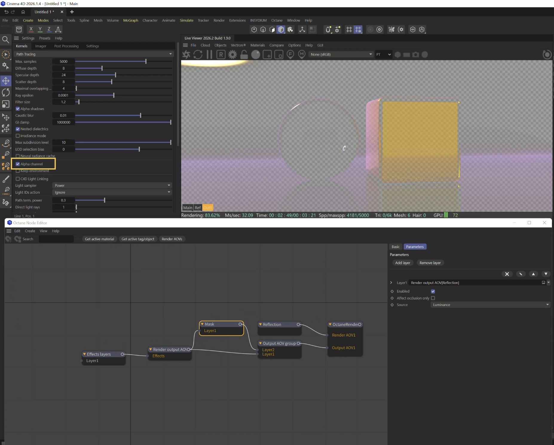

Have a look at the following example scene:
AlphaReflectionAOV.zip
(312.69 KiB) Downloaded 38 times
First of all you need to enable the "Alpha channel" option in Kernel settings.
Then, in Output AOV Compositor tab you need to create a new Output AOV.
In the first layer you need to add a Render AOV of the Reflections pass, and on top of it a second layer with Mask node connected to Reflection pass in Luminance mode:

bepeg4d wrote: Thu Apr 16, 2026 8:41 am Hi,
Happy GPU rendering!
ciao,
Beppe
