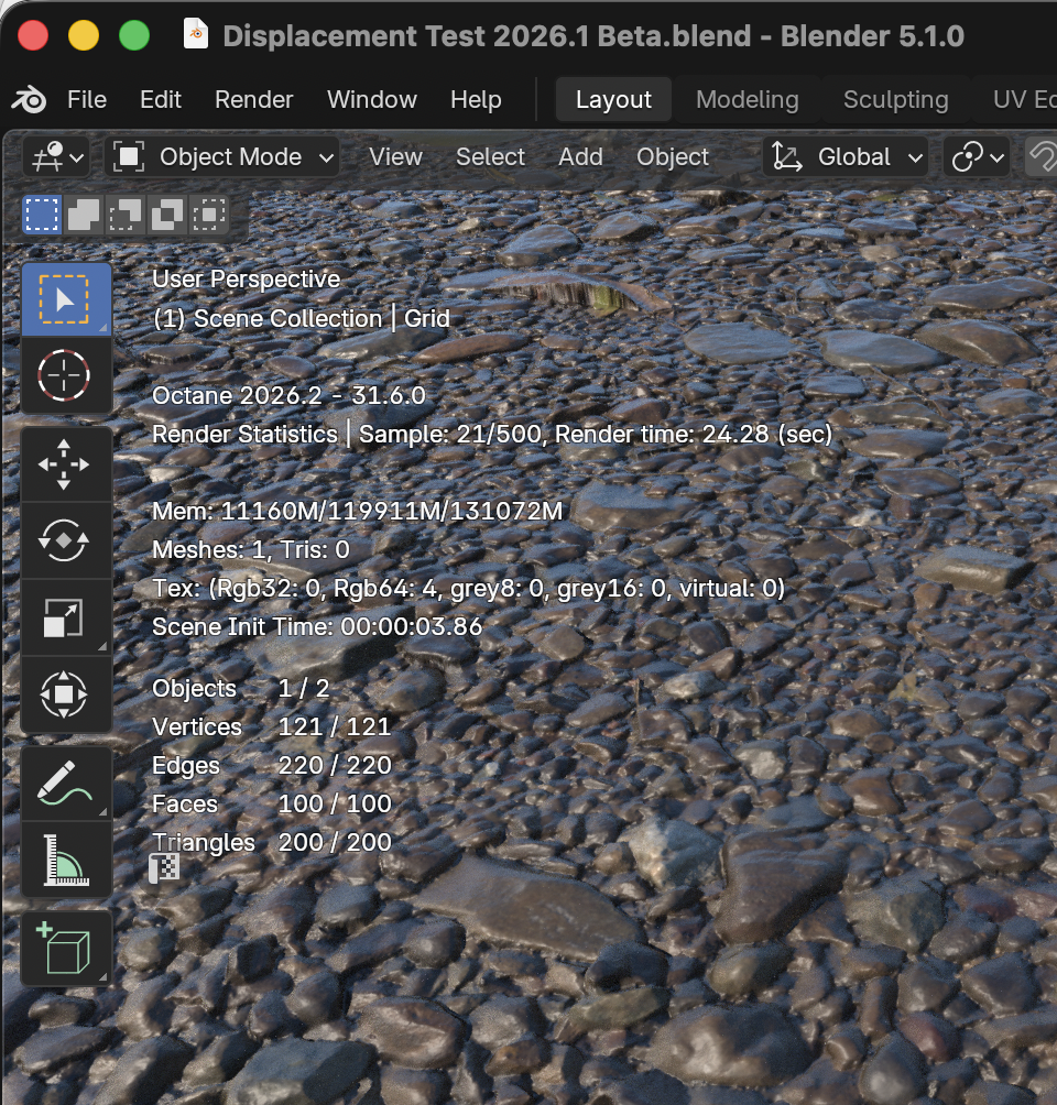

128GB unified Memory M4 Max.

I have tested the High Displacement Setting on OSX 31.7 Blender Addon. PBR Textures work but the noise is super unreliable. It freezes quite reproducably after a few seconds.
I have created a very simple scene. Lowering the 3D Transform Scale to 0.001 pushes it quickly over the edge. Changing rendered Mode to Solid and Back makes the viewport usable again for a few seconds.
