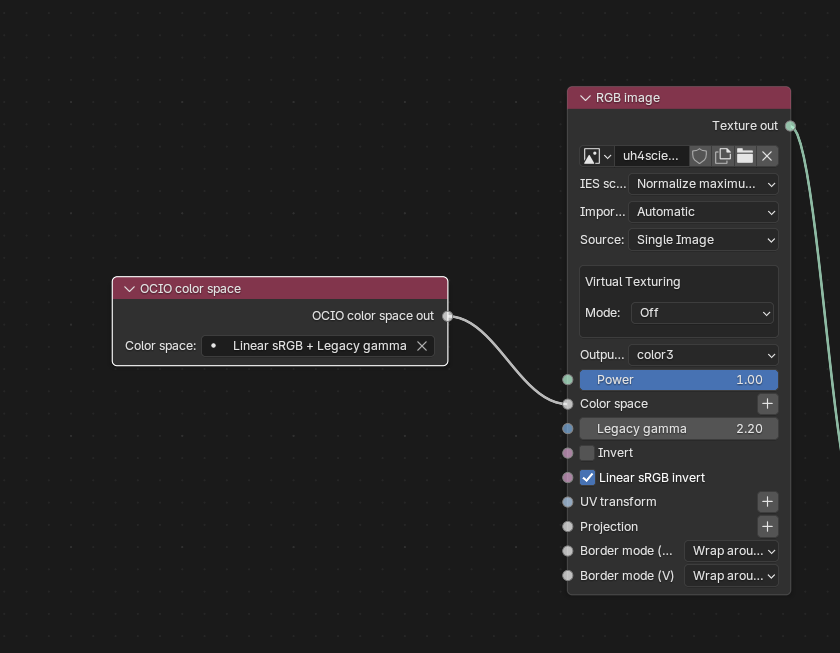

When loading some older projects in this new version, you may notice that color textures appear brighter in the render.
This happens because the Legacy Gamma option in the RGB Image node no longer works correctly unless an OCIO Color Space node set to Linear sRGB + Legacy gamma is added.
This is particularly noticeable for image textures connected to the Albedo input.
To help with this, I've created a small addon that automatically adds the missing OCIO Color Space node where needed.

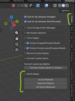

Once installed, you will find the following options in the Octane sidebar:
Smart Exclusion (tries to exclude "non color" nodes attached to Roughness, Bump, Opacity, Displacement etc. and so on)
  • Active Material
  • Selected Objects
  • All Scene Materials
All Images nodes (adds the OCIO nodes to all connected Image textures nodes)
  • Active Material
  • Selected Objects

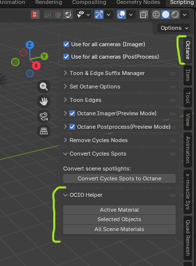

These tools will automatically detect image textures connected to the Materials and insert the required OCIO node.
I hope this helps!
