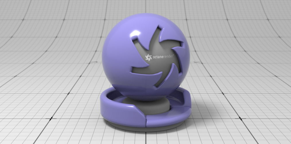

Hesekiel2517 wrote: Sat Jan 10, 2026 10:23 am4. Solo Mode
The add-on that a user created works great. Nevertheless, it would be great if this feature were already integrated into the Octane add-on.
The idea is to eventually implement a native “solo” preview mode, similar to what we have in Standalone.
It’s not trivial to integrate cleanly into Blender’s architecture, so it will take some time, but it’s definitely on the roadmap.

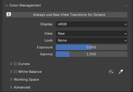

Hesekiel2517 wrote: Sat Jan 10, 2026 10:23 am5. Blender output is not the same as Octane output.
I like working with AGX, which works great with Octane output. However, if you use the regular Blender renderwindow, color management does not work.
When working with Octane inside Blender, color management should generally be kept neutral in the Blender render view.
In practice, that means using settings like Raw / No View Transform, as shown above.
Octane manages color internally (or via Octane Compositing / Imager), and applying Blender view transforms on top of that can lead to unexpected results.
That said, AGX can absolutely be used with Octane as well. You just need to download and use the corresponding OCIO configuration, and let Octane handle the color transform through its own pipeline, rather than relying on Blender’s viewport color management.
This way you get a consistent AGX-based look while keeping Octane’s output predictable and physically correct.
