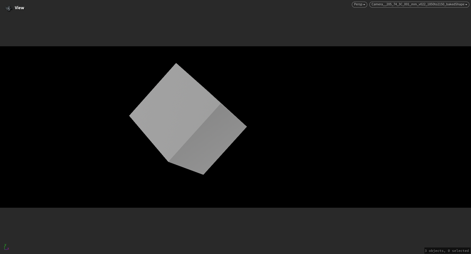

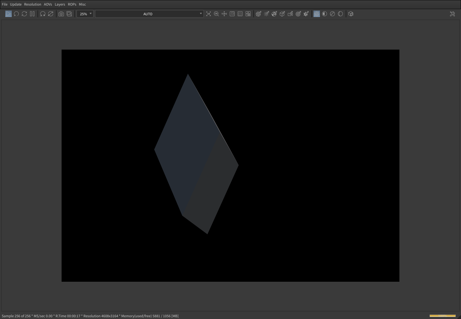

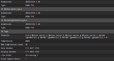

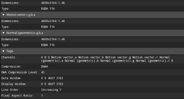

Is there a way to render with 2 px aspect ratio? I need to render some objects for compositing onto raw anamorphic footage, but Octane seems to ignore this specific camera setting.
Images attached to further illustrate the problem:
houdini camera set to the correct resolution with 2 px aspect ratio
houdini viewport correctly showing the desqueezed image
Octane IPR ignoring the 2px aspect ratio, showing the result "squeezed"
rendered EXR incorrect with 1px aspect ratio

Hey there!
I will need to investigate this.
I think it should be possible, but could be that there is a bug here.
