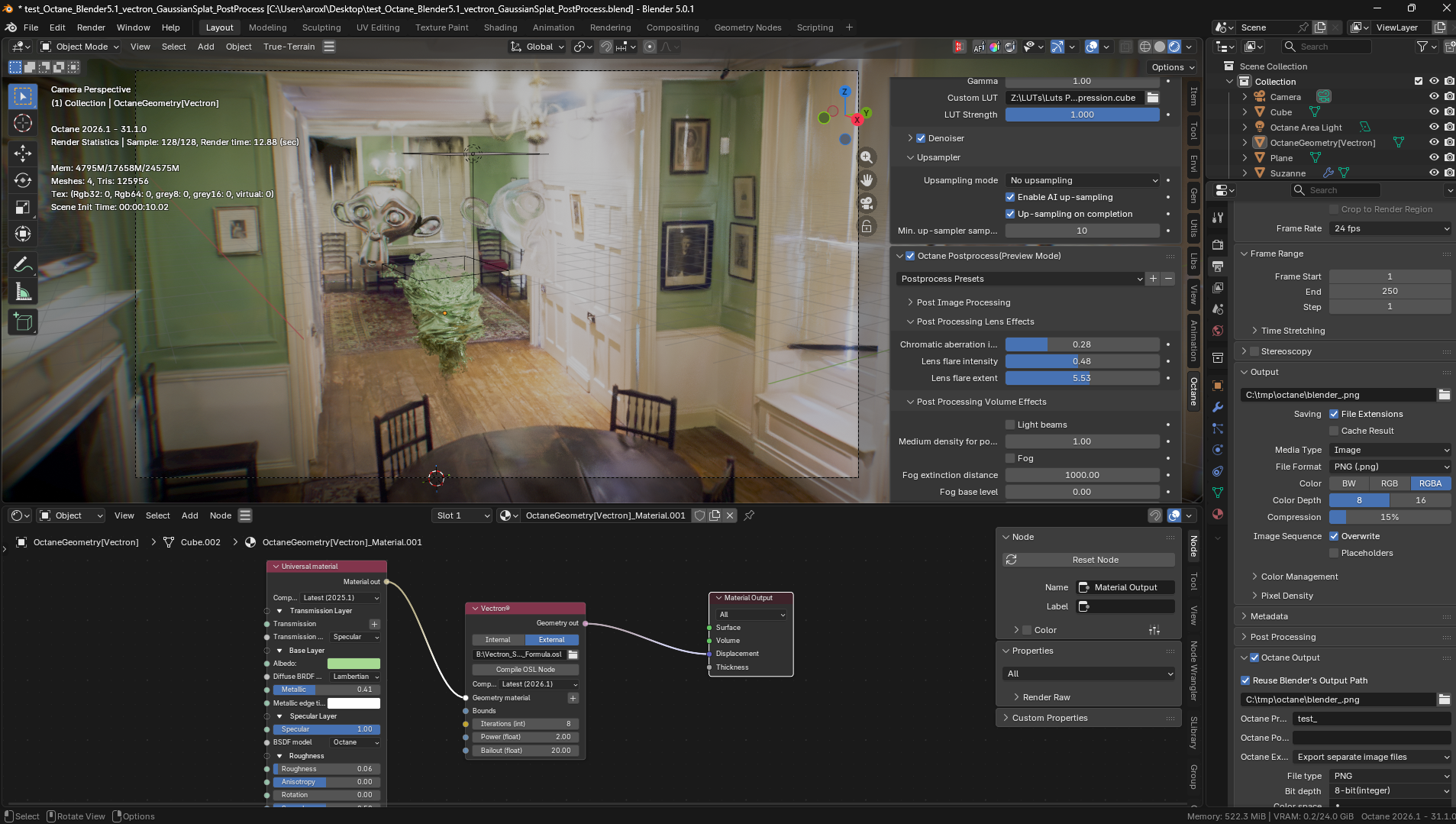

Hi everybody, I did some vibe coding to patch the Blender 4.5 plugin for the latest version of Blender 5. After a few hours, I managed to have a (apparently) fully functional plugin, I also put the plugin link . Here is a recap of what has been done :
Octane Plugin Compatibility Patch for Blender 5.0.1
This document summarizes the modifications applied to the Octane Blender plugin
(v2026.1 Beta originally built for Blender 4.5) in order to make it fully functional
in Blender 5.0.1.
1. Color Management Fix
Issue:
The plugin failed to enable because the UI panels
RENDER_PT_color_management_curves and
RENDER_PT_color_management_display_settings
were removed from the Blender 5.0 API.
Fix:
File:
octane/uis/color_management.py
Action:
All imports and references to the removed color management UI panels were deleted.
2. Grease Pencil v3 Compatibility
Issue:
Plugin registration failed with the error:
AttributeError: type object 'Types' has no attribute 'GreasePencilv3'
In Blender 5.0, Grease Pencil types were merged and the specific GreasePencilv3
type no longer exists.
Fix:
File:
octane/properties_/geometry.py
Action:
The register() and unregister() functions were modified to dynamically check for
the existence of GreasePencilv3.
If the type does not exist (as in Blender 5.0, where only GreasePencil is present),
the registration step is skipped gracefully instead of crashing.
3. Kernel Selection Crash (AttributeError)
Issue:
Selecting "Quick-Add Kernel NodeTree" caused a crash because
node_tree.active_output_node was None during initialization.
Fix:
File:
octane/utils/utility.py
Action:
Added robust None checks in the following functions:
* beautifier_nodetree_layout_with_nodetree
* find_active_output_node
Fallback logic was added to locate any valid kernel output node when the active
output node is not yet defined.
4. OSL Node Crash and Editability
Issue:
OSL nodes caused UI crashes (EXCEPTION_ACCESS_VIOLATION) and their parameters
were read-only.
The root cause was that Blender OSL sockets do not support ID properties
(self["value"]), which the plugin was incorrectly using for custom getters
and setters.
Fix:
File:
octane/nodes/base_osl.py
Actions:
* Removed custom getters and setters:
All set= and get= arguments were removed from socket property definitions,
reverting them to standard Blender RNA properties.
* Fixed default value initialization:
The is_new_input check in build_pin was removed to ensure default values are
properly assigned during OSL node compilation.
Result:
OSL nodes no longer crash the UI and are fully editable.
5. Final Render Crash (F12)
Issue:
Pressing F12 caused an immediate hard crash (EXCEPTION_ACCESS_VIOLATION)
inside octane_blender.pyd.
Root Cause:
The Octane C++ binary was compiled for Blender 4.5 and attempted to access the
RenderPass C-struct of Blender 5.0 using an incompatible memory layout.
The struct changed in Blender 5.0, resulting in illegal memory access.
Fix: "Buffer Proxy" Strategy
File:
octane/core/frame_buffer.py
Action:
* Blender 5.0 is detected at runtime.
* A gpu.types.Buffer is allocated to act as a proxy framebuffer.
* Octane is initialized with is_viewport=True even during final render.
This forces the C++ binary to write into the raw buffer pointer instead of
accessing Blender's incompatible RenderPass structure.
* Pixel data is manually synchronized from the GPU buffer to Blender's render
result using:
render_pass.rect.foreach_set(arr)
Result:
Final rendering (F12) works correctly in Blender 5.0.1, including:
* Beauty pass
* Denoised pass
* All AOVs
No modification or recompilation of the C++ binary was required.
result using:
Result:
* Beauty pass
* Denoised pass
* All AOVs
- Attachments
- OctaneBlender V5.0.1 Addon 2026.1 - 31.0 Beta Release [TEST].zip
- (12.45 MiB) Downloaded 46 times
