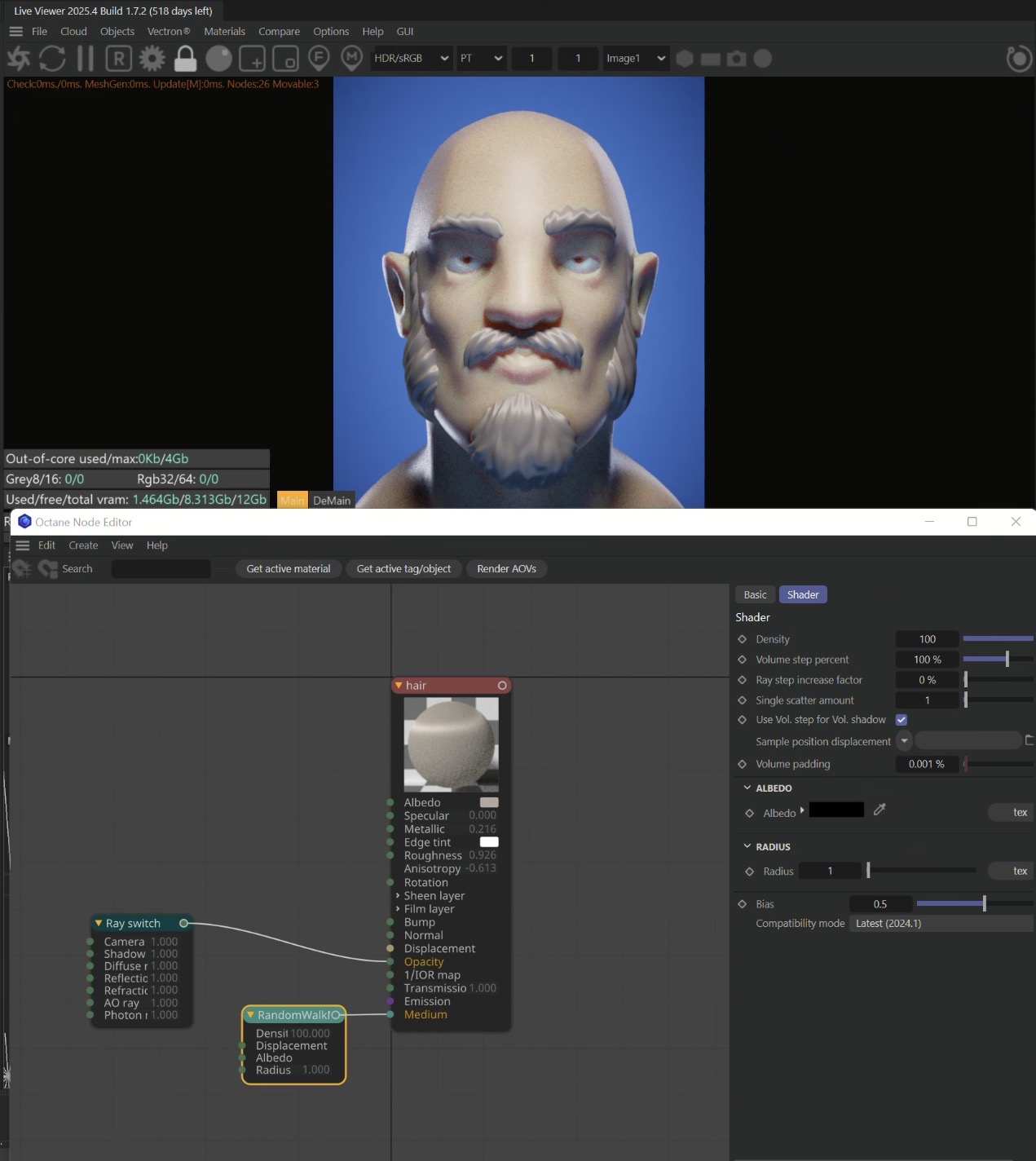

- One head mesh with randomwalk SSS skin material with a Randomwalk Medium (diffuse transmission).
- Some hair meshes with just a regular material

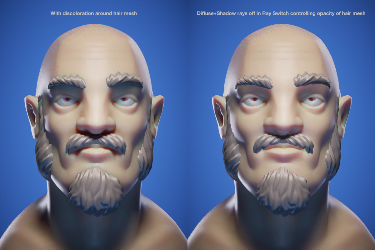

Where the hair objects intersect the head mesh I get this greenish dark color, which probably makes some sense technically but looks quite bad.
My thought was that I might be able to get around this by using the Ray Switch node controlling the Opacity of the hair mesh material, but no combination of this gets me to the desired result.
The only way to get rid of the dark color tint around the hair mesh is by turning off both Diffuse and Shadow rays, but that of course removes all shadows from the hair meshes overall, and I don't want that.

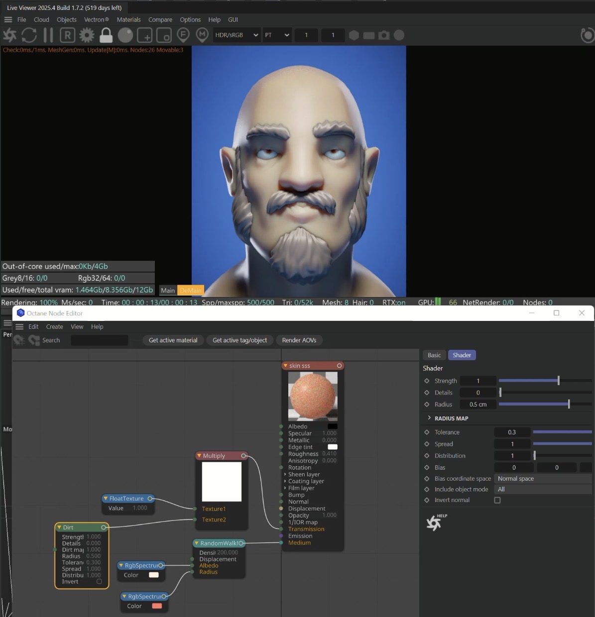

If you multiply the Transmission color with a little bit of Dirt in the Skin material, the issue is solved: ciao,

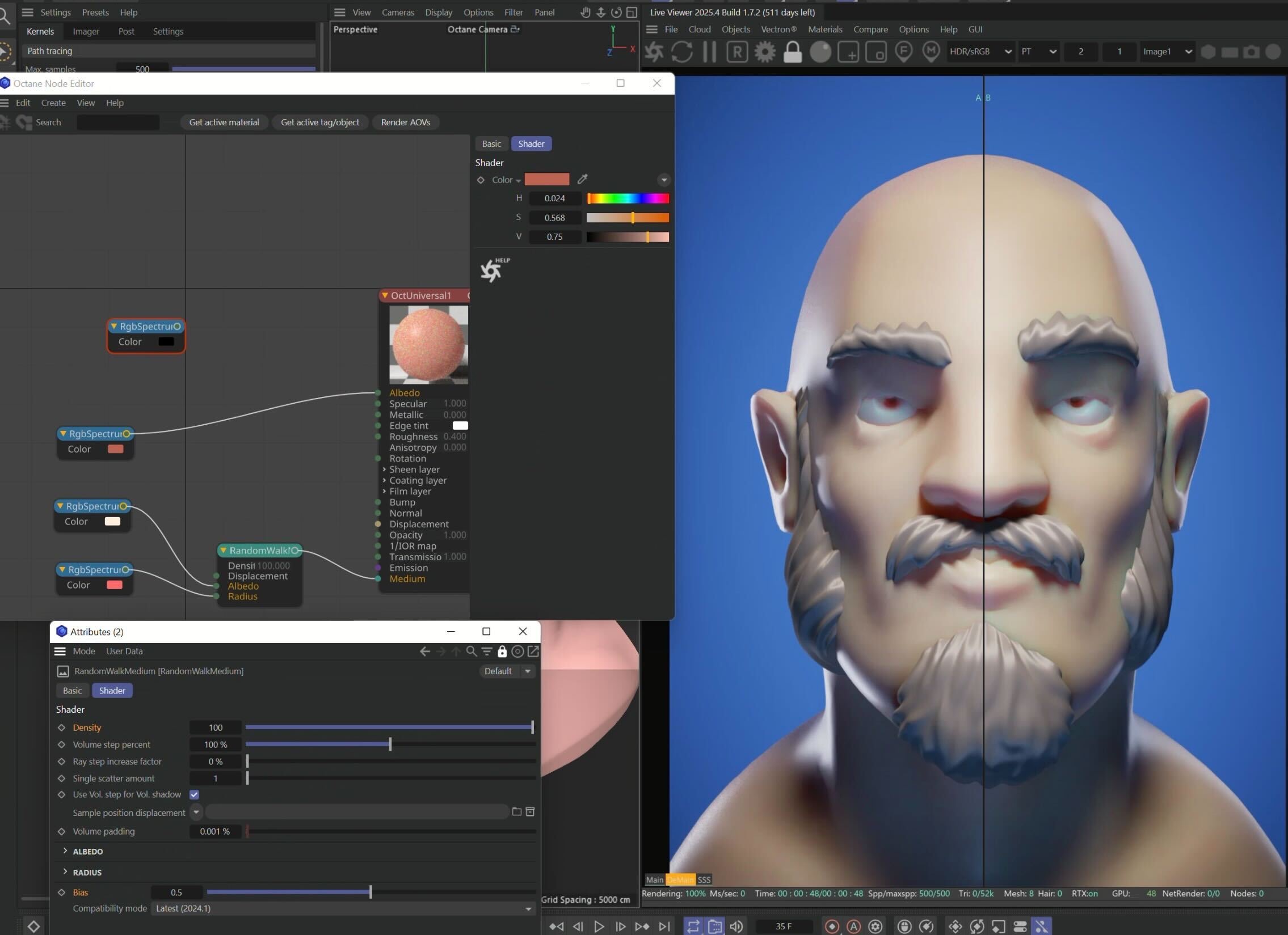

Ok, have a look at this different solution.
If you also add a Random Walk node to the Hair object with default settings and Transmission to 1, the dark greenish coloring goes away: About Ray Epsilon issue with Random Walk, it is a known issue and should be fixed in one of the next core update.

Did a super fast test, and now it seems that controlling the opacity of the hair object with the Ray Switch node (diffuse and refraction set to 0) will actually remove the halo. Strange, as I feel that it didn't work the last time...
