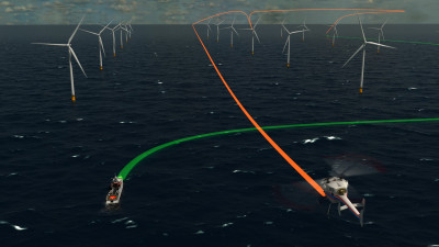

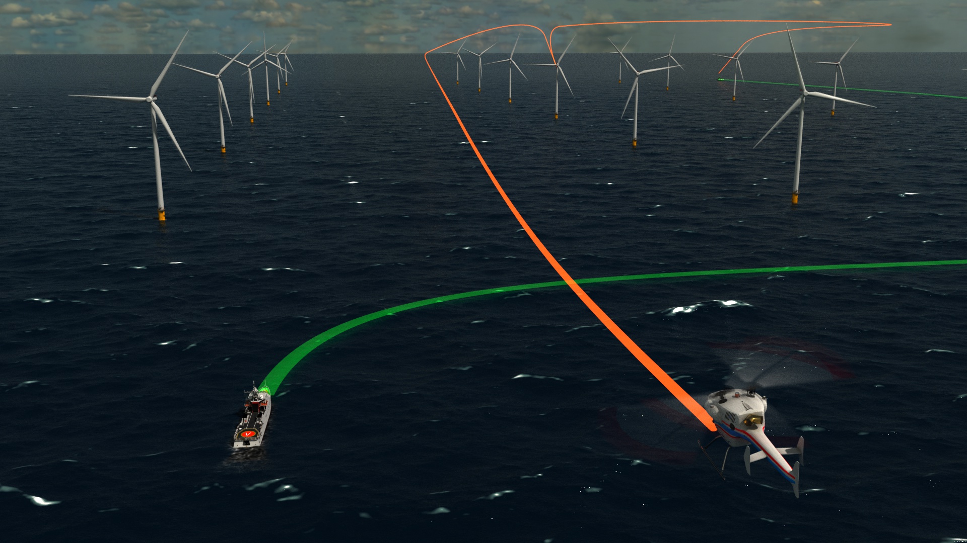

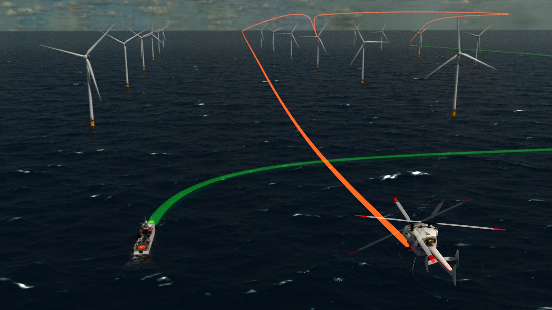

I have some trouble with the motionblur of a helicopter rotor. In Octane 2022 (on my old mac Pro) it works fine with one sample in the octane global render settings...
In Octane 2025.4 1.7.2 it looks quite wrong.
Here with one sample, two samples and 8 samples.
I miss the blur between the samples... all have camera settings 0,02 sec for shuttertime...Every rotor blade has a motionblur tag...
Please help I am in the middle of production.
Kind regards
Martin

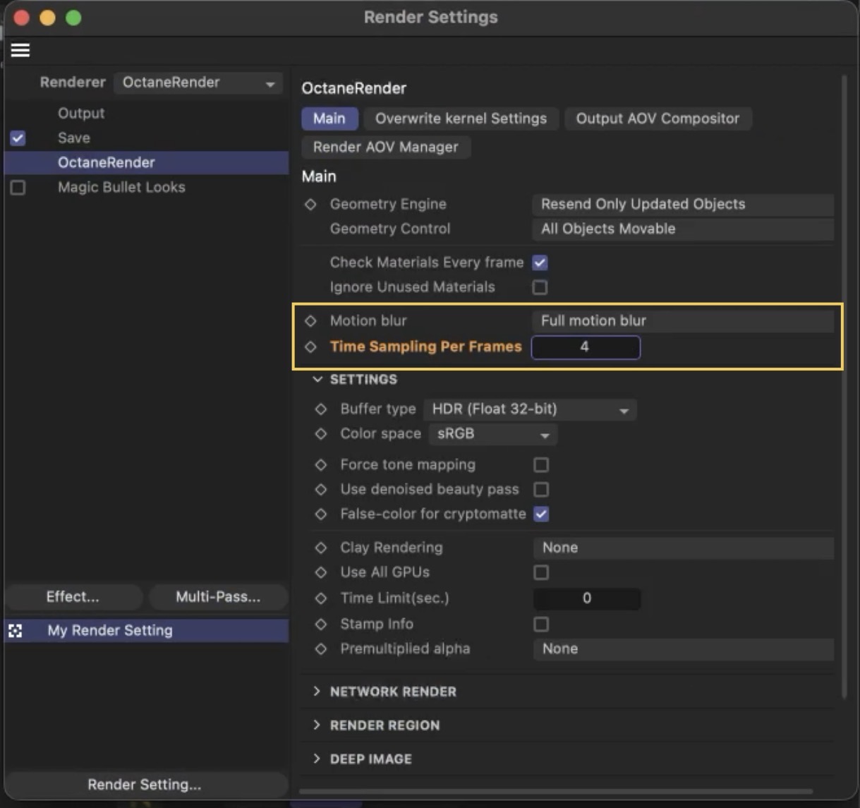

Hi Martin,
Please set the "Time sampling per frame" at 4 in Render Settings/OctaneRender/Main tab and report back, thanks:

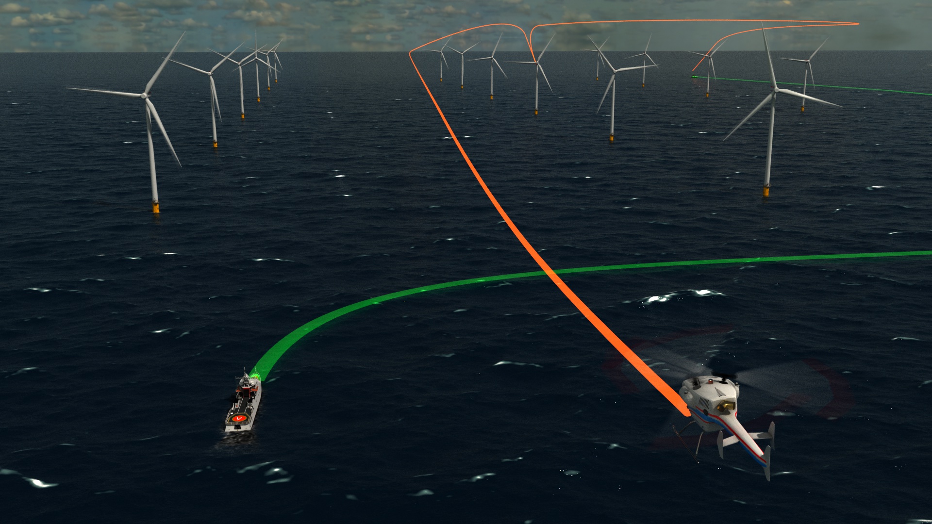

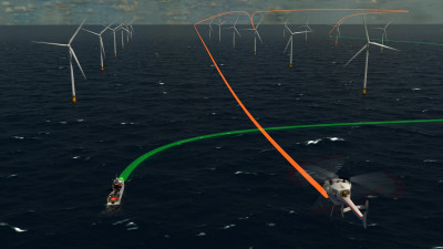

Timesampling per frame 4 does not change anything, there is no blur between the samples of movement...
See attached picture.

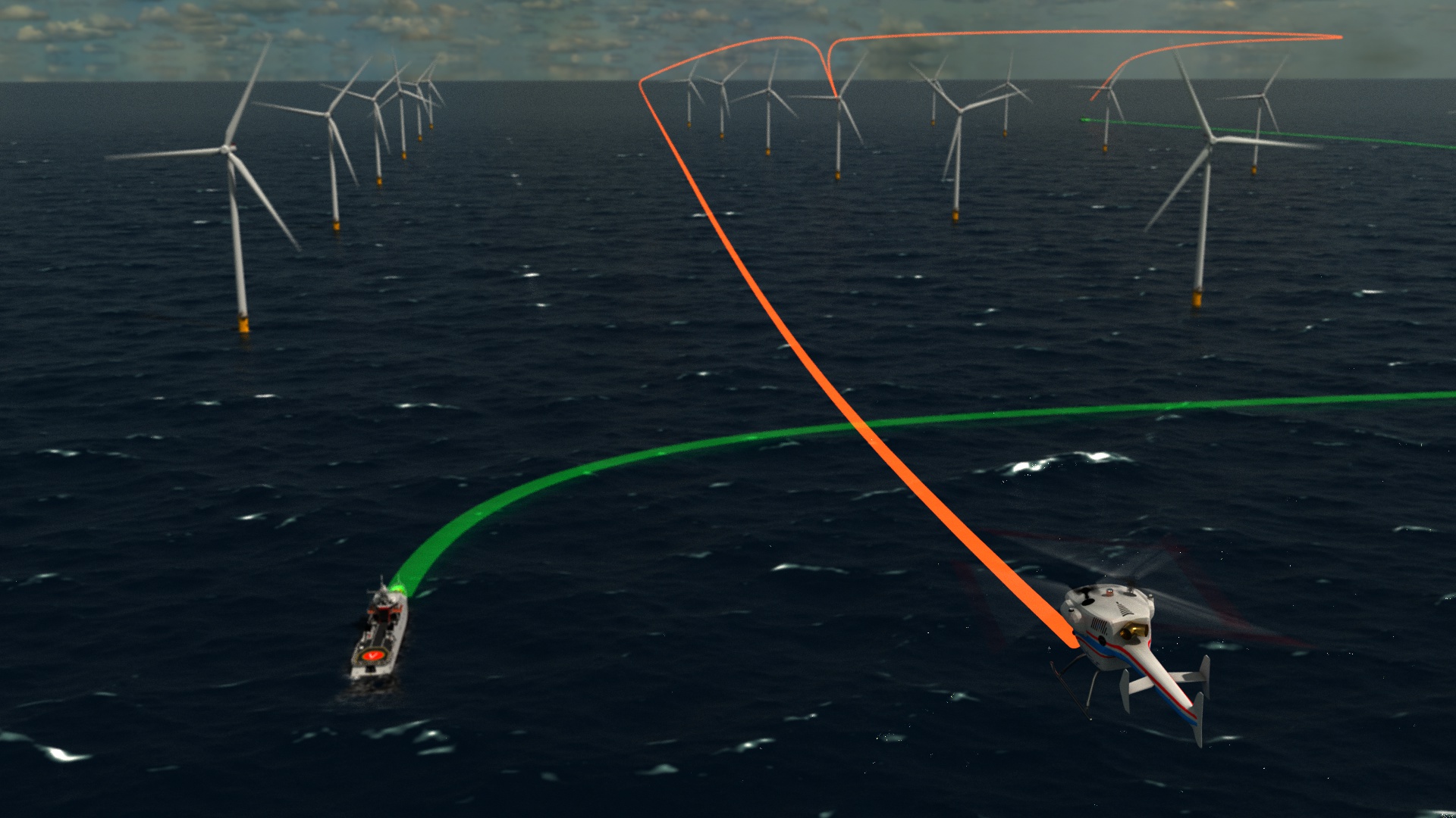

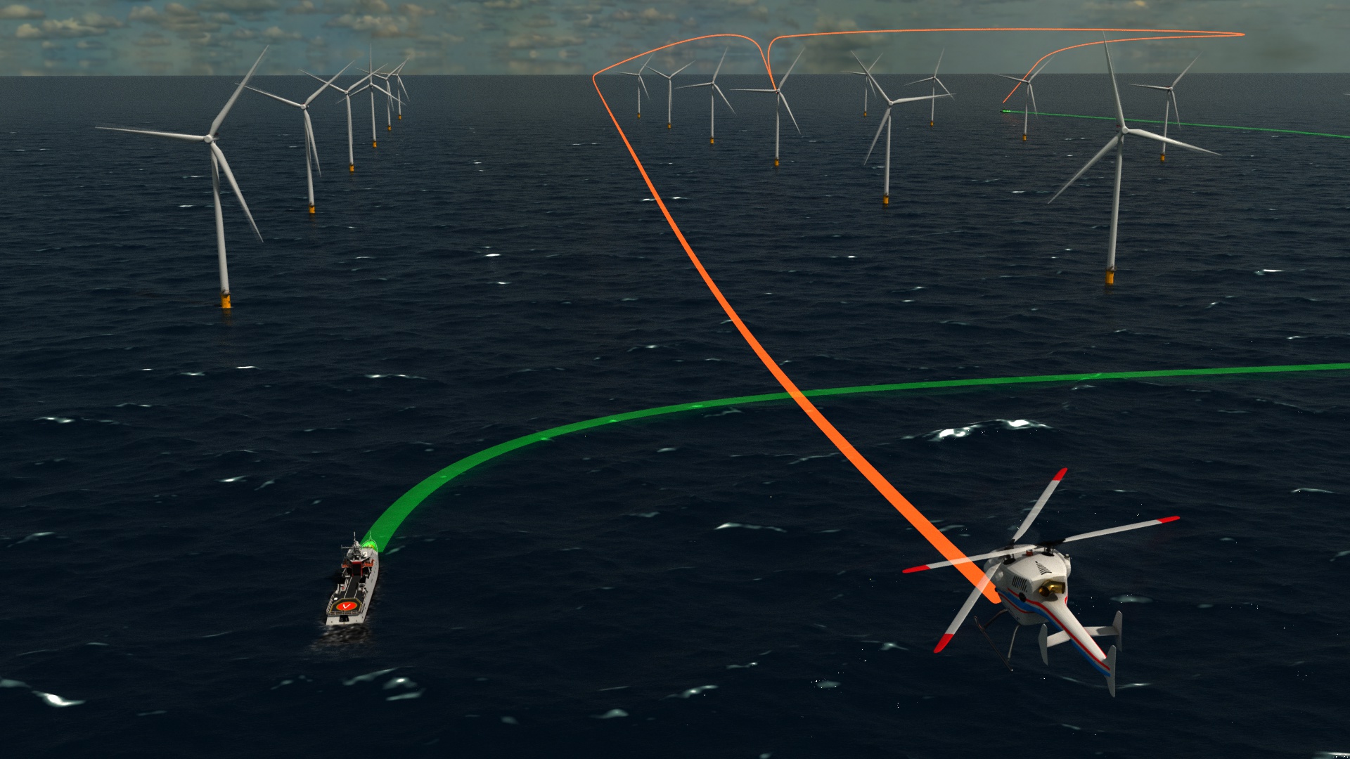

found the solution!!! I animated the rotor with automatic curve continuation!
I thought maybe a key at the end could help... so it does!
But sure its a small bug when c4d continuing a keyframe animation the motionblur is not working correctly!
Here the same rendering with 8 timesamples...it looks perfect...with 4samples it is not perfectly round.. but much better than before
Thanks Beppe for your help.

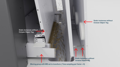

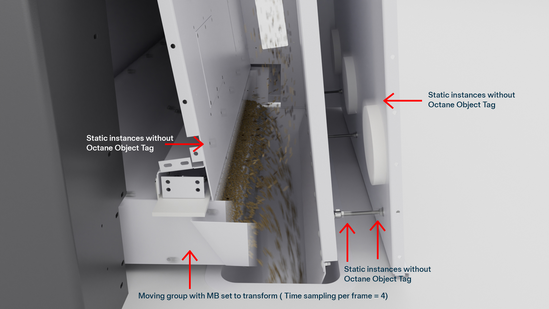

I'm currently also experiencing that the "Time sampling per frame" motion blur setting is causing problems.
I have an assembly that is set into rotation by a dynamics motor and constraints. All instances outside of this group also receive motion blur, even if they are static and do not have an Octane Object Tag.
Time sampling per frame = 4 is causing the issue, set to 1 the problem disappears.
I will try to reduce the project file next week to make this bug reproducible.

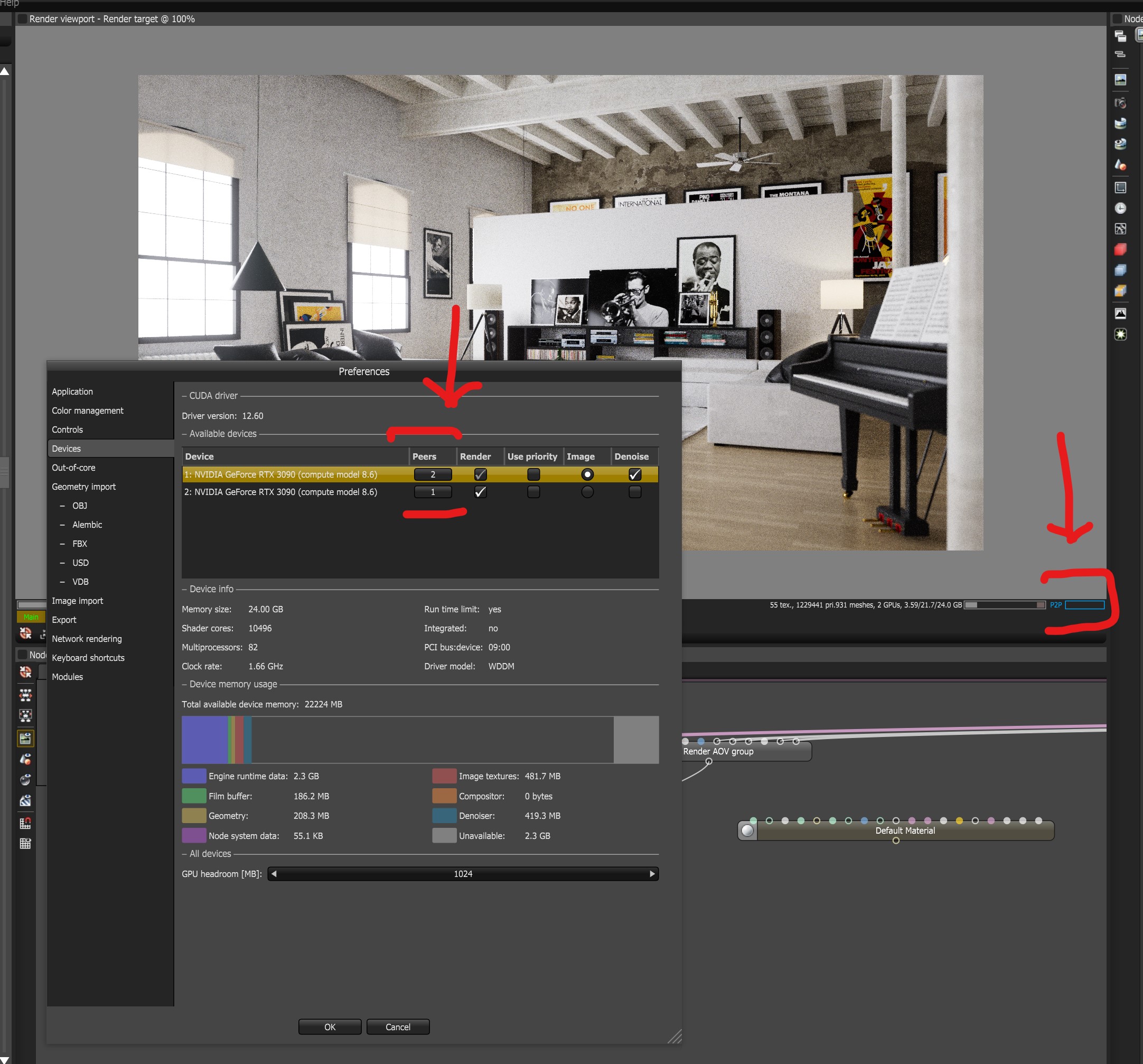

Could you guys please implement the Memory Pool graphic just like Octane Standlaone provides? It is really helpful for 2x3090 + Nvlink Setup.
Regards,
C4D 2025.3.3 Octane v1.9.4 // Octane SA 2026.4, Windows 11 Pro, X399, AMD TR 2950X, <<2 X 3090 + NVlink>>, 128 GB RAM, Corsair 1500i - NVIDIA SD 610.62

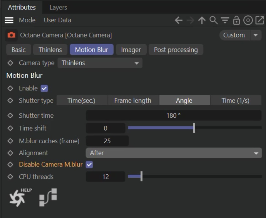

@dasmodular:
Have you tried to disable the Camera motion blur in the Octane camera Tag?
ciao,
Beppe
