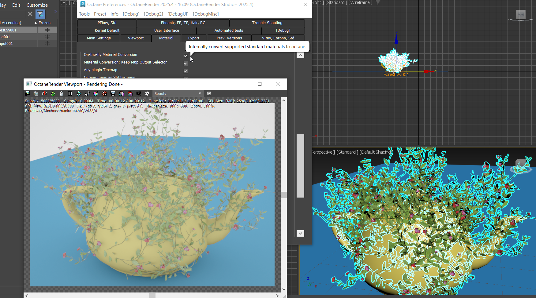

ForestPack IVY objects can be rendered directly with Octane, without converting materials.
Just make sure that 'On-the-fly Material Conversion' is enabled in Octane Preferences, Material tab.

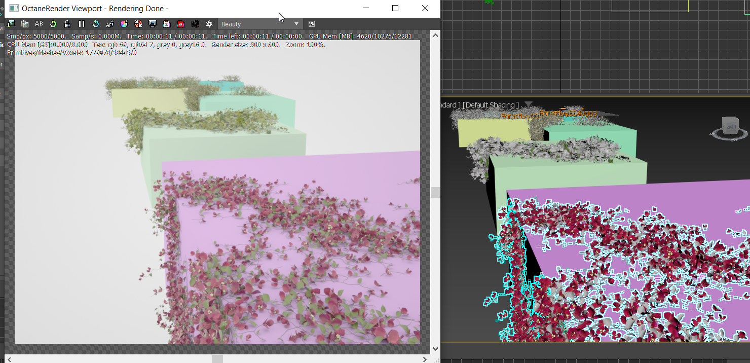

Here are a few samples:

Instances
Forest IVY create instances of geometry (leaves, flowers,..), to reduce memory usage and increase performance.
Those instances are directly used as Octane 'Scatter' nodes.
The branches are generally created as a single mesh.
Early support
Note that we tested samples using the Forest Ivy library, keeping the default parameters.
Those samples use a Multi Material assigned to the main IVY object, with several Physical materials.
Leaves use opacity maps, and Double sided materials, that are now correctly handled by Octane.
There may be some other cases that we do not support correctly yet.
Please let us know, and post samples if you encounter such issues.
