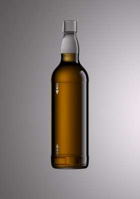

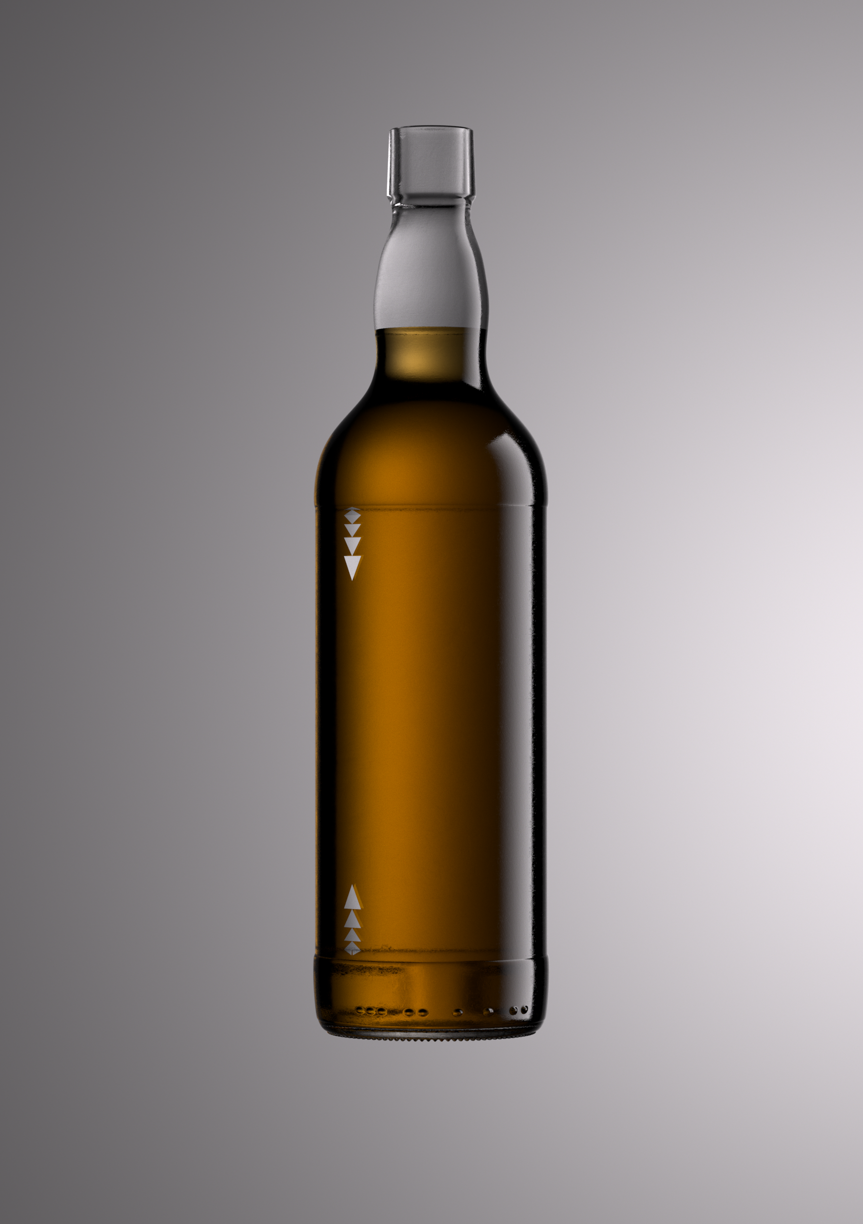

I am using a displacement map to create some details on a bottle.
The bottle is UVd, the displacement map is 4K, 16bit.
I'm getting weird triangular artefacts. I've tried just about everything I can think of, but can't identify what's causing them.
Can anyone shed any light on this issue?
mitchino
Posts: 455
Joined: Thu Jul 14, 2016 4:49 pm
Fixed it - I have 2 x glass materials, one for the outer surface of the bottle, and one for the inner surface - forgot to switch off the displacement for the inner material.
