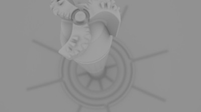

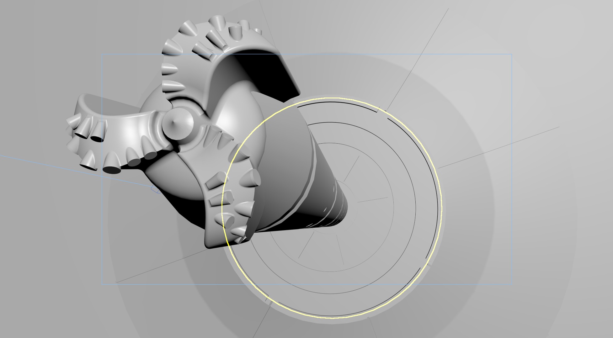

Hey, no havent updated to that yet.
See attached how mine works.
one is viewer other is 3ds max viewport
