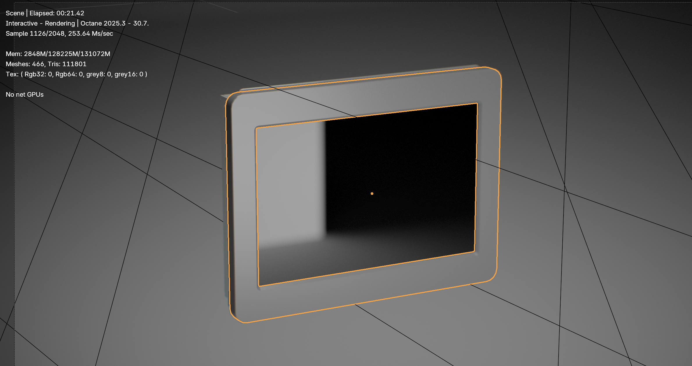

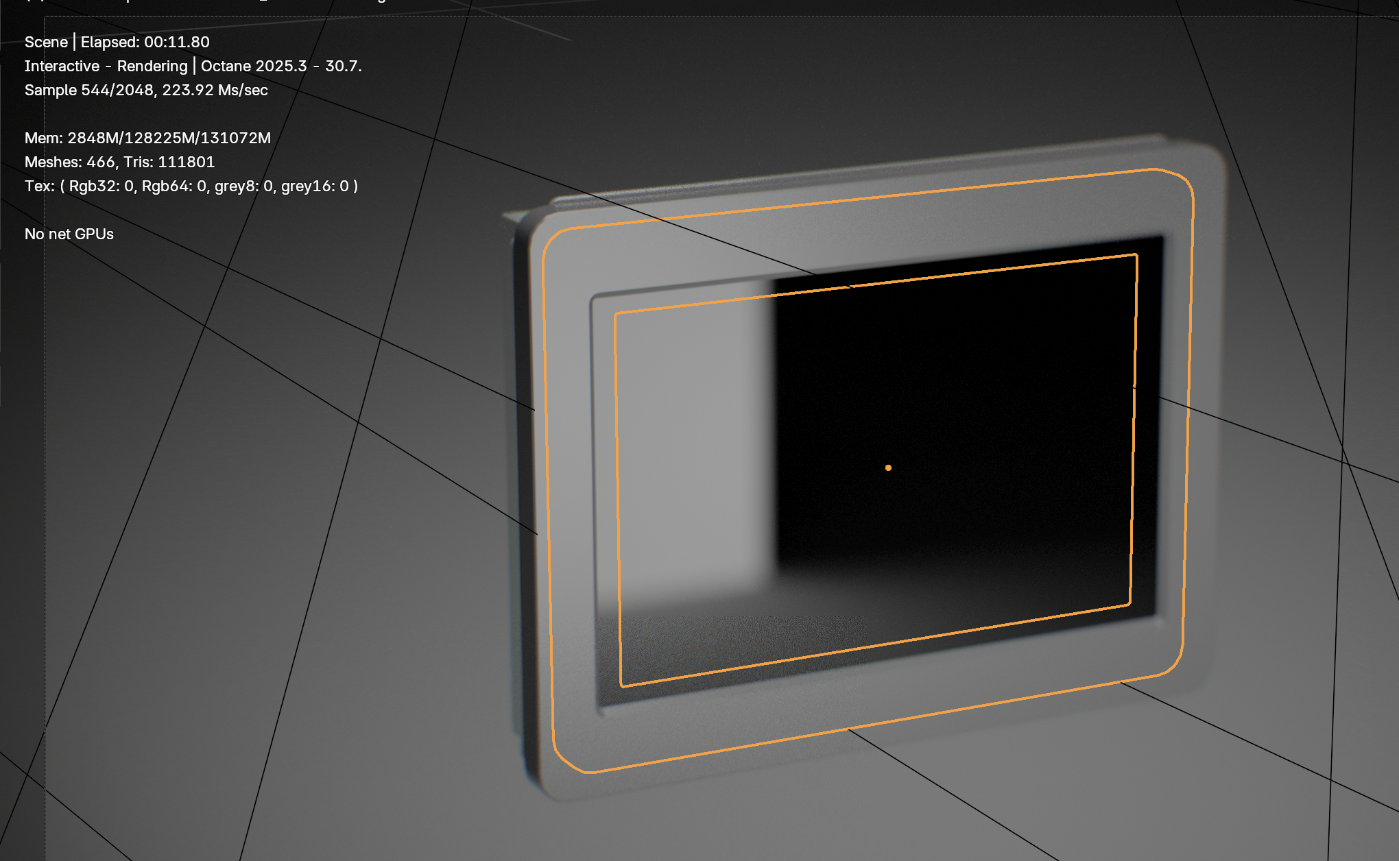

When using the Realistic Lense the Selection Outline does not match. This is quite annoying when selecting objects.
Blender Octane OSX 30.7
See screenshots attached
Realistic Lense Selection Outline Bug

That's expected, since the final render is the result of optical distortion that only happens at render time. The same happens when using Universal Camera and its distortion effects.

Hi Lino,
the top image is the universal lense. When you hover over the picture you see the file name with the lense name.

Try applying any optical distortion (Spherical, Barrel, Aberration and so on) from the Universal Camera, and you’ll notice a mismatch. The Realistic Lens camera simulates true optical distortion and lens effects, which can’t be accurately reproduced in the 3D viewport preview.
