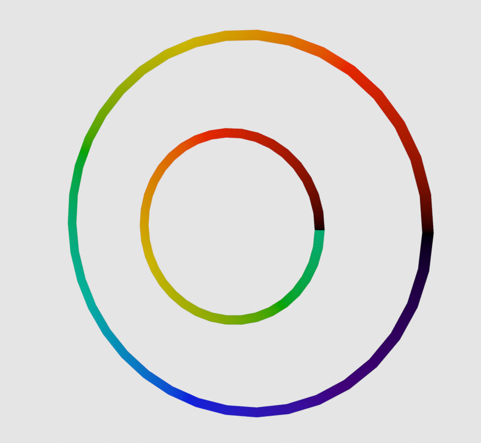

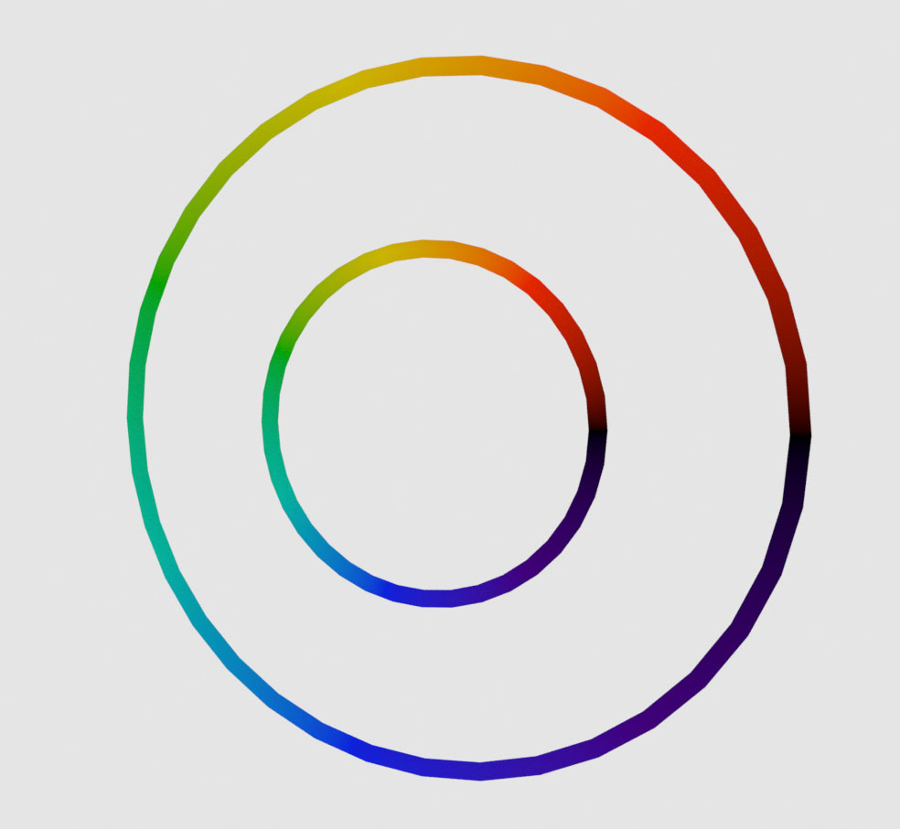

I'm looking for a solution regarding mapping UV size on splines. Currently UV's are scaled to the full length of the spline. I'm looking for a solution to set a specific length/value inside the Octane material so the UV will map to a specific length before it tiles, regardless of the length of the spline itself. Ideally this would be completely done in the material itself, without the need for Xpresso links or external transformations which have to be manually assigned/linked.
I've illustrated the current situation below, and the preferred result. This is done by tiling the material to 0.5, since the spline is exactly half as long but this doesn't work when I have a lot of splines at different lengths.

Sorry, but I cannot see a way of doing this in c4doctane, we cannot interact with geometry properties inside octane materials.
Since you need to change the Length Y value in C4D Material tag, I think you need Xpresso or a Python script.
