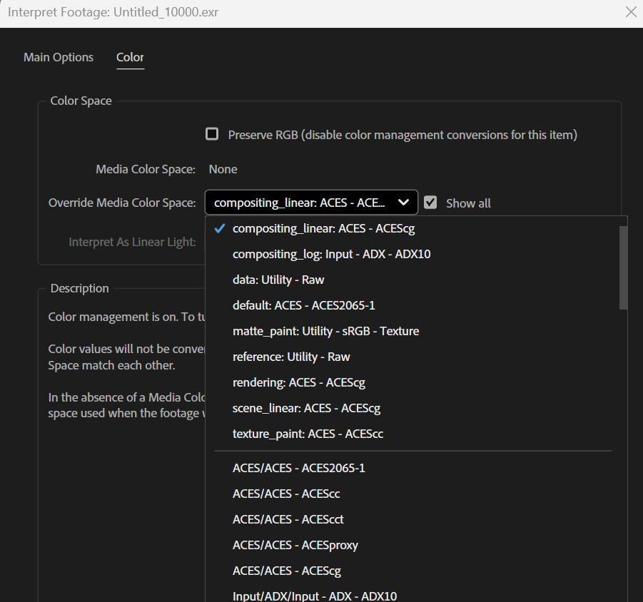

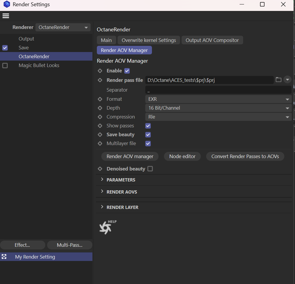

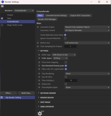

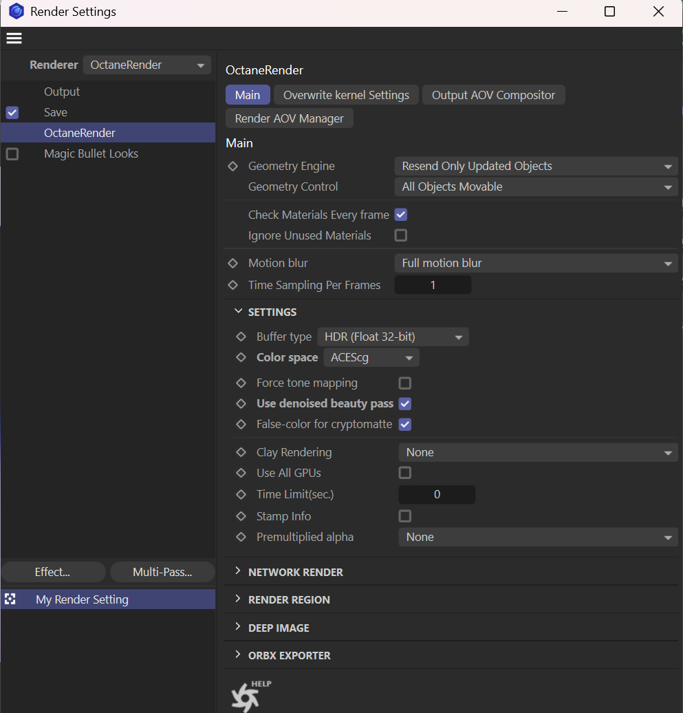

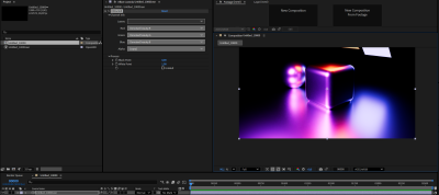

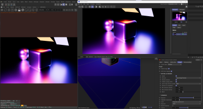

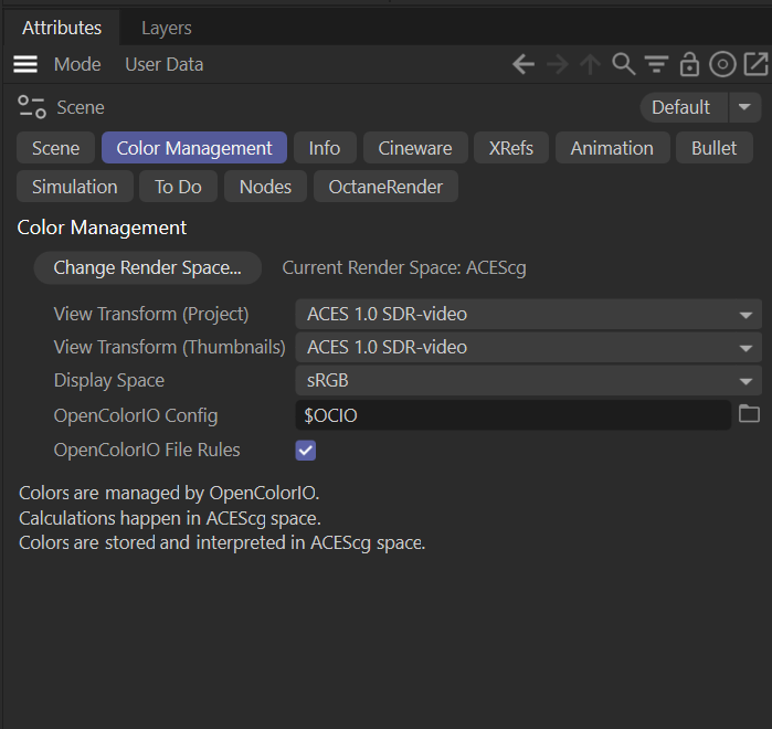

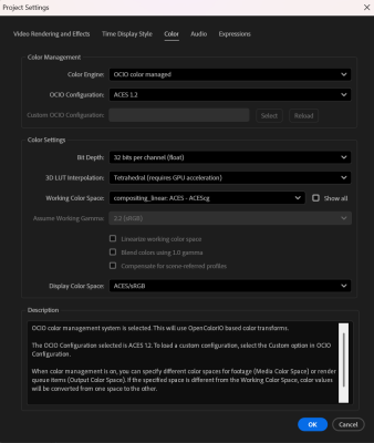

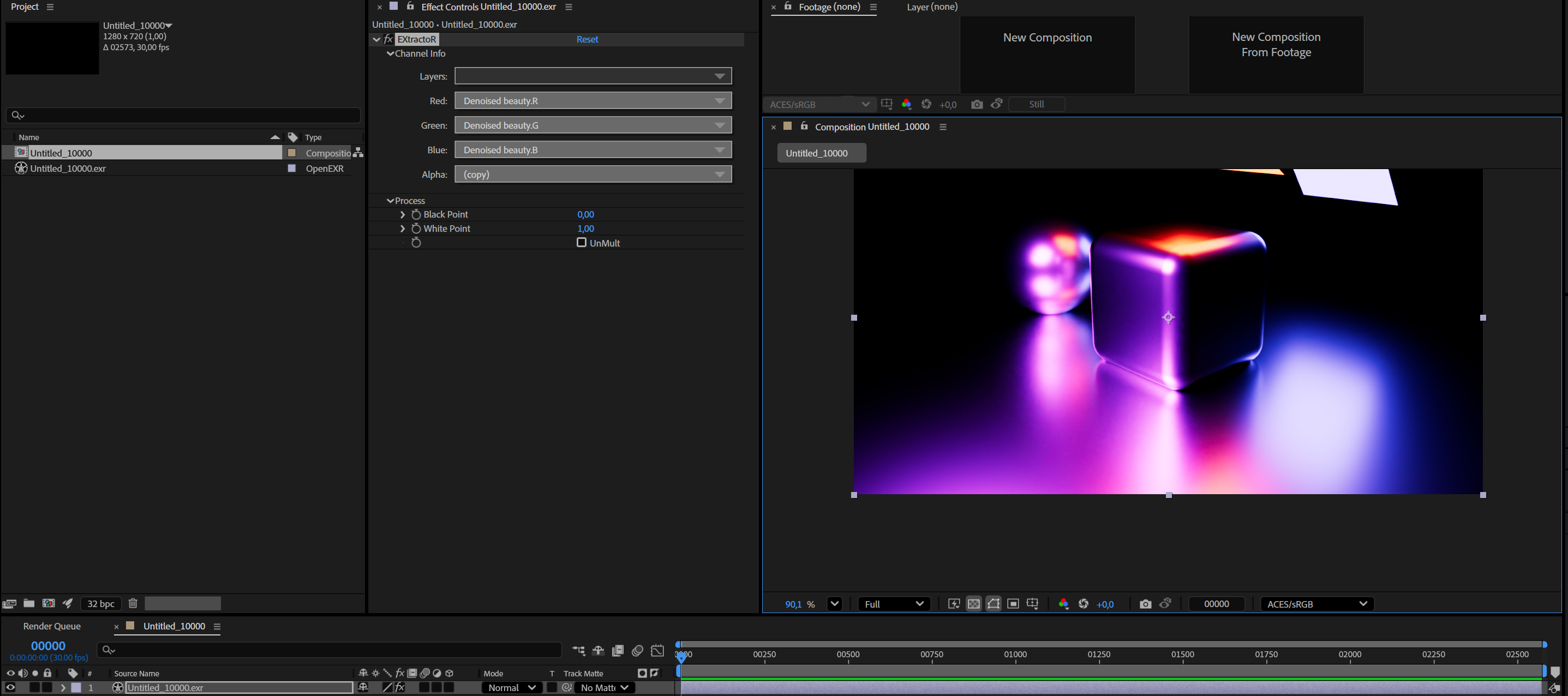

I just tried the "normal" workflow using the latest plugin build 1.7.2 and AE 2025 and it seems to hold up fine.
I am not using the linear legacy sRGB color management here, because I don't mind the c4d color picker not looking right but otherwise it should work fine
