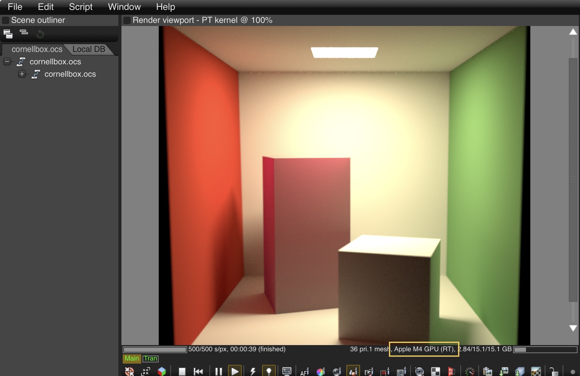

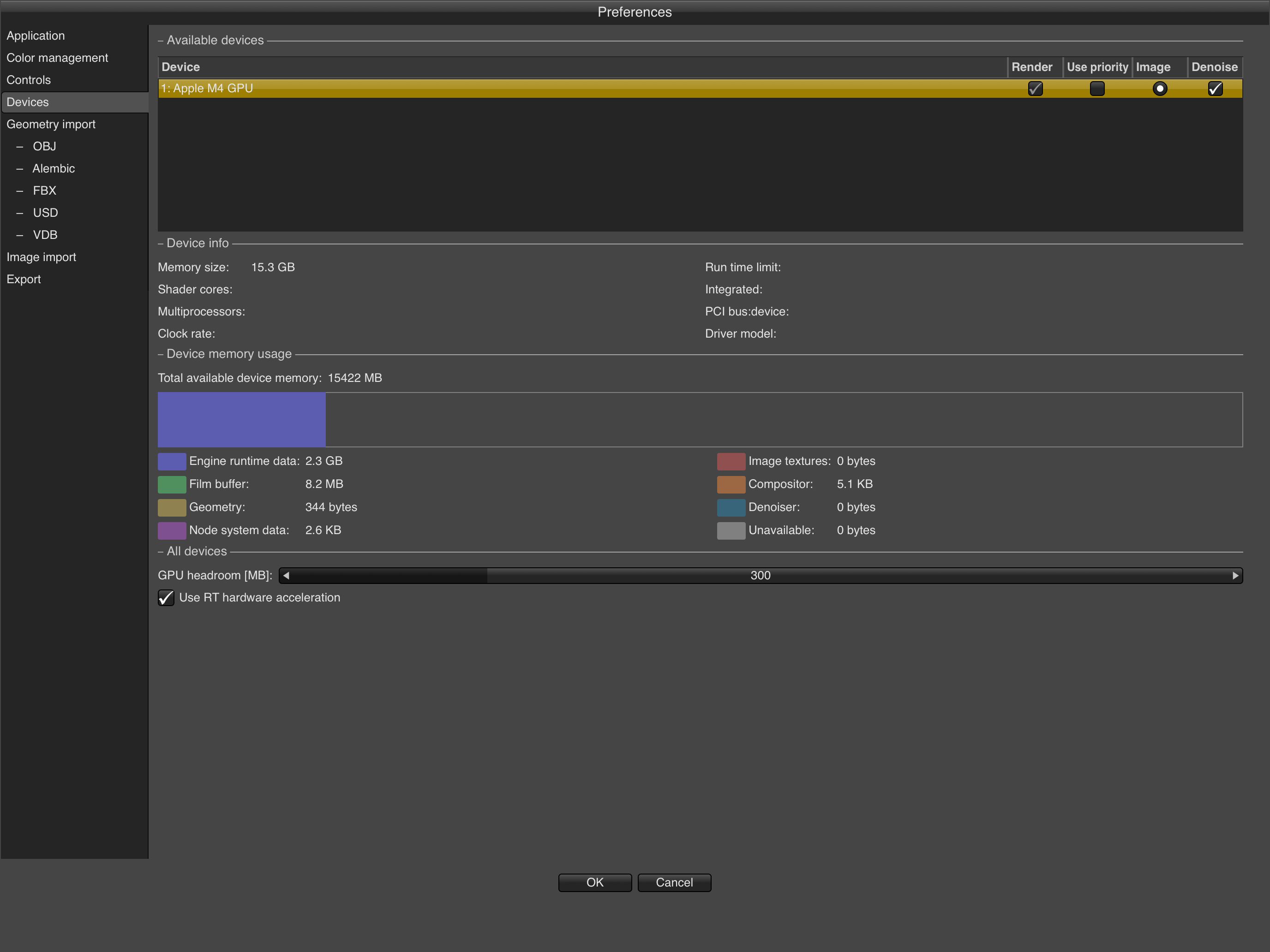

OctaneX works great on iPad Pro M4, but you need iPadOS 18 or 26:
ciao,
Beppe
