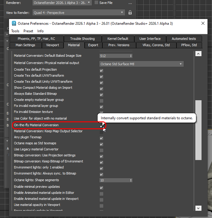

Octane plugin can use Autodesk materialX material and textures directly, by performing an internal conversion when rendering.
For this, make sure to enable 'On-the-fly Material conversion' in Octane preferences / Material tab:

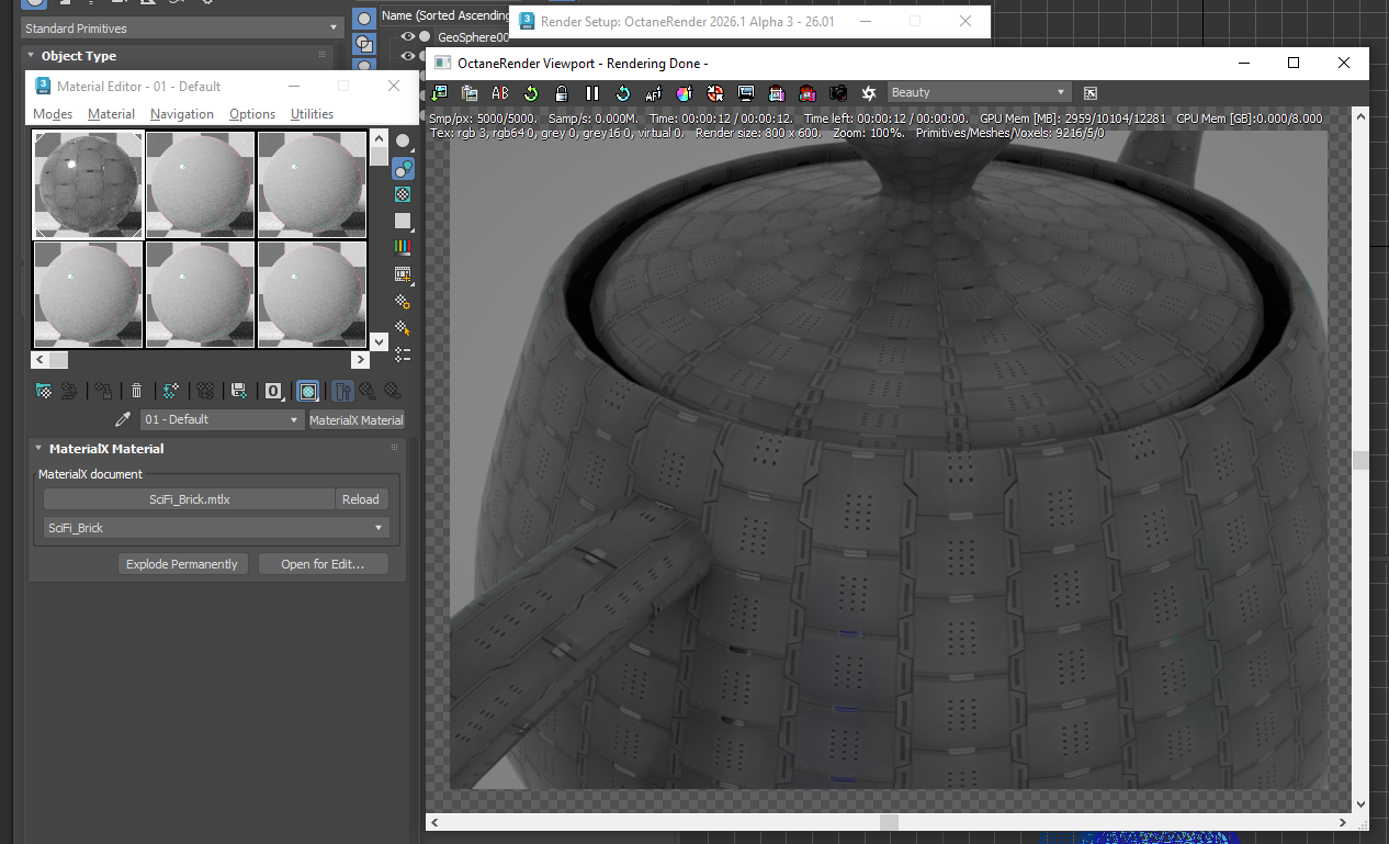

Create a standard MaterialX material:
Materials / General : MaterialX Material
Select your .mtlx file with the <Pick MaterialX File...> button.
This material can be rendered with Octane renderer, as well as with Arnold renderer.

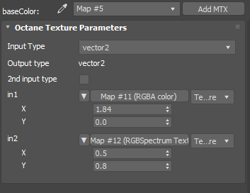

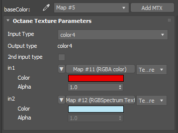

Sub textures of simple types (RGB spectrum, RGBA color, Float Texture, ...) can be expanded automatically as the same type as the output type, to be edited directly.
For example, expanding a RGBA color when the output type is set to color4 will show a rgb color swatch and a float for alpha.
Changing the output type to vector2 will only show 2 float values.
This helps making clear what values will be actually used.

AMD/mtlx_SciFi_Brick01_mx22.max
Teapot001 uses the standard MaterialX (01 - Default)
AMD/mtlx_SciFi_Brick02_mx22.max

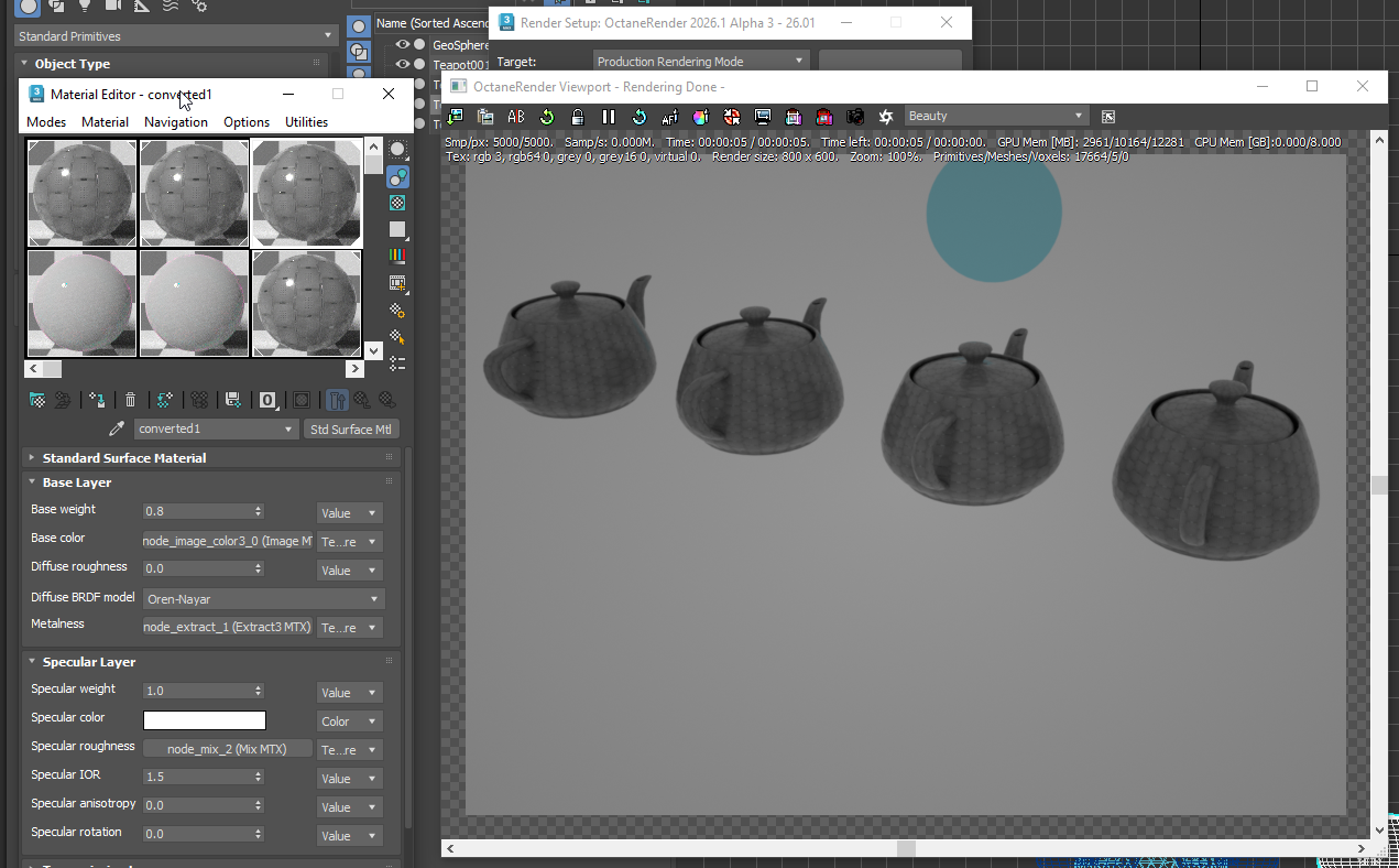

Teapot002 uses a copy of the original MaterialX, that has been exploded (01-exploded, a standard Physical Material)
Teapot003 was converted from 01-exploded. (converted1, an Octane Std Surface)
Teapot004 was converted from the original material 01 - Default (converted2, an Octane Material Switch)
Note that converting to Octane from a standard MaterialX will add a Material Switch, and add all sub-materials in the switchable material list.
Using 'Explode permanently' will explode only the selected sub material. This can then be converted to Octane too, and won't have a Material Switch because there's only 1 material.

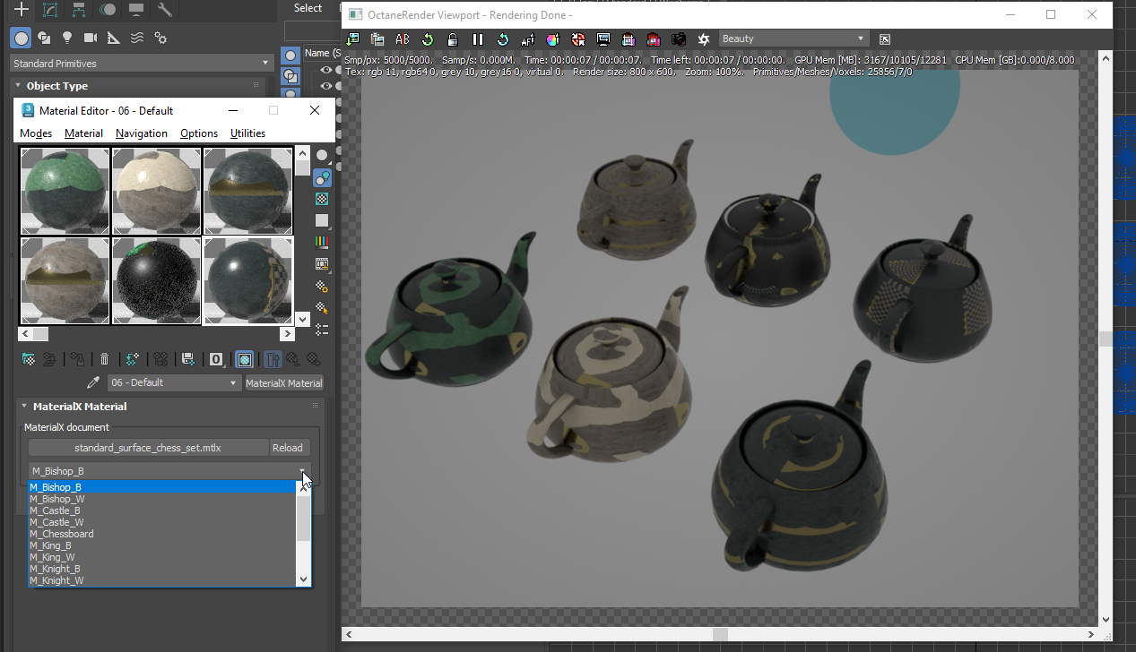

StandardSurface\Chess_set_test01.max
standard_surface_chess_set.mtlx is a MaterialX with multiple sub materials.
The standard MaterialX Material interface has a selector to choose one of the available sub materials.
6 copies of the material are using the same mtlx file with a different sub material selection.
