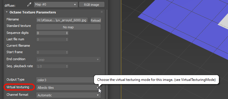

Virtual texturing can be enabled in image textures, like the 'RGB image' texture:

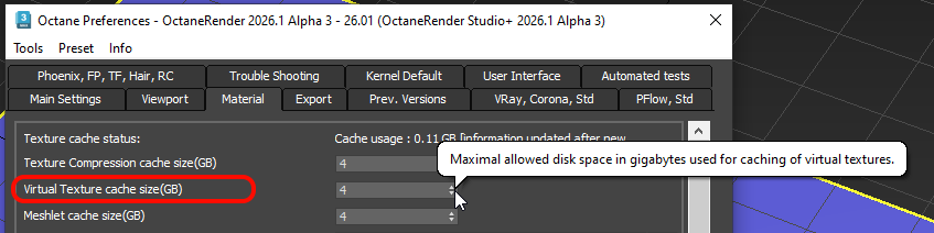

Virtual textures cache size:
Use Octane Preferences: Material tab:
Select the size with the parameter 'Virtual Texture cache size (GB)'

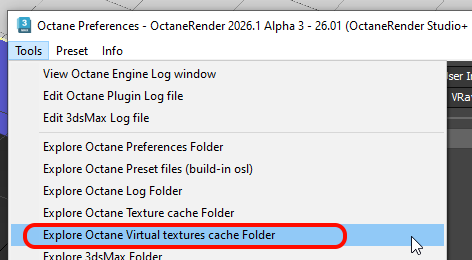

Virtual textures cache location:
Use Octane Preferences: menu Tools/Explore Octane Virtual textures cache Folder to open Windows explorer.
This should be a folder like C:\Users\xxxxx\AppData\Local\OctaneRender\cache\vtex
You can delete those cache files, but you may need to close 3dsMax when files have been used.

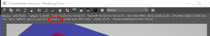

A new texture type 'virtual' is displayed in the Octane Viewport info options : "Tex: rgb NN, rgb64 NN, grey NN, grey16 NN, virtual NN.":
This can be enabled in Render settings / Kernel tab: Enable stats in viewport, and Render statistics customization :
