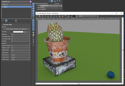

To use Gaussian splats on 3dsMax:
Create a Gaussian Splat object from the Octane category.
Create Octane Gaussian Splat object.png (9.24 KiB) Viewed 5076 times
Note that this object uses a dummy box in the 3dsMax viewport
Select a .PLY file with the 'PLY file...' button
Open Octane viewport to check the rendering.

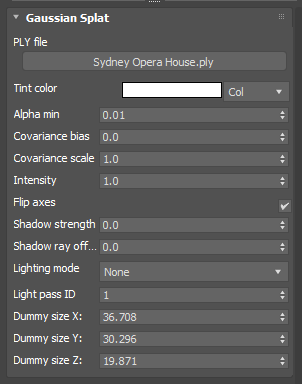

Adjust the object parameters
Octane Gaussian Splat object.png (8.48 KiB) Viewed 5076 times
Note that the 'PLY file' button has a context menu (right click) with Explore, Clear and Reload options.

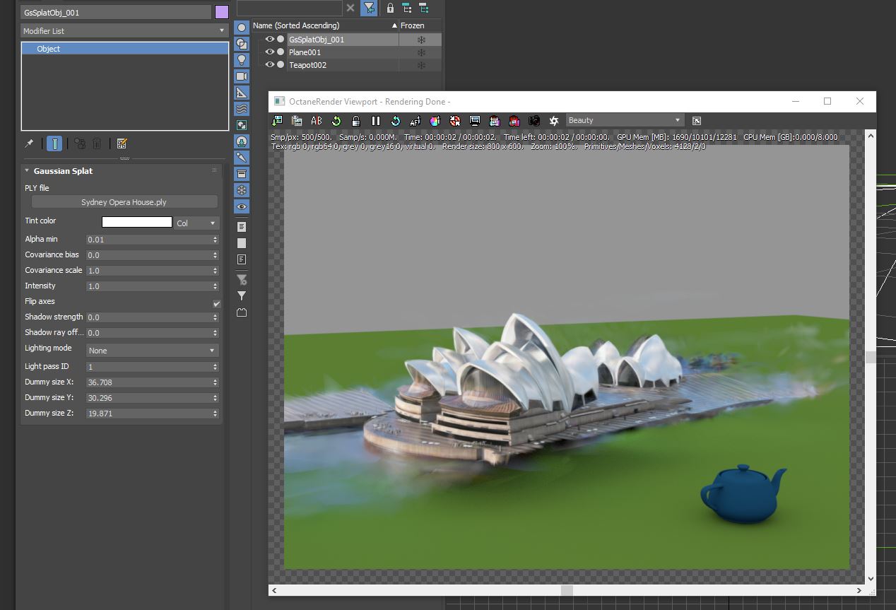

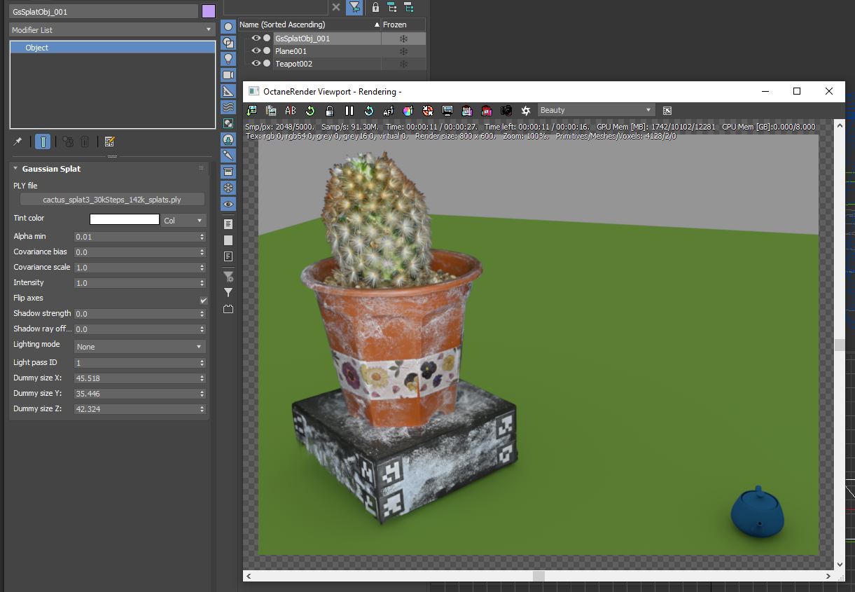

Here are some examples:
GaussianSplat_Sample01_Cactus.max
PLY file reference: Steam Studio : https://www.steam-studio.jp
GaussianSplat_Sample02_Sydney.max
