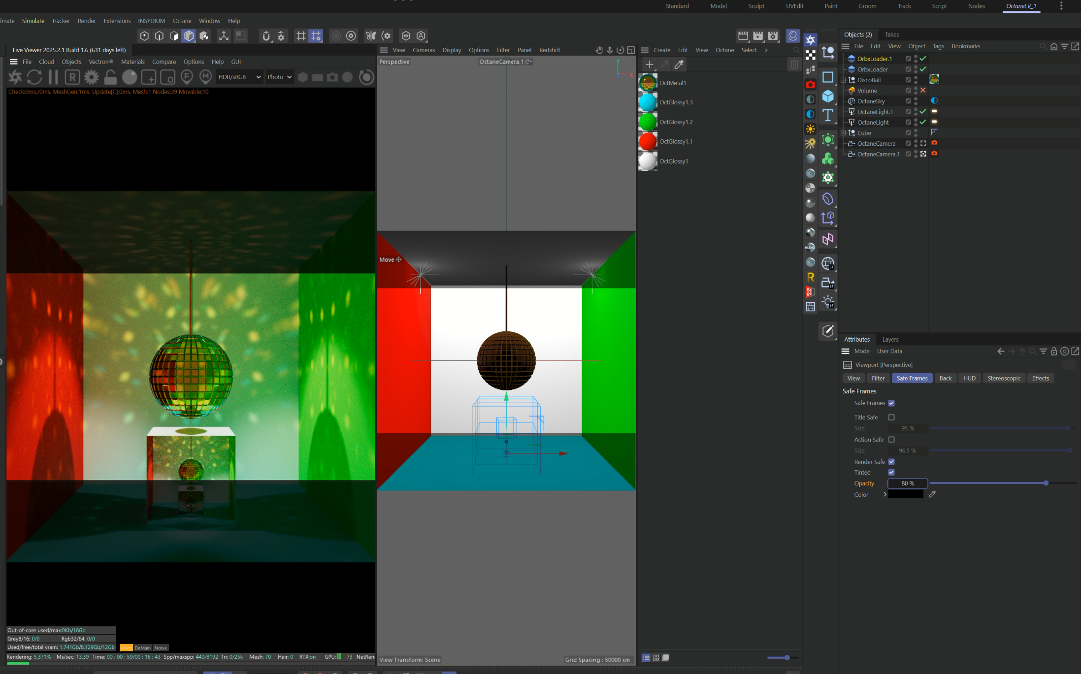

When i set the safe frames opacity to 100% it doesn't add the black bars to show the aspect ratio in the preview window anymore.

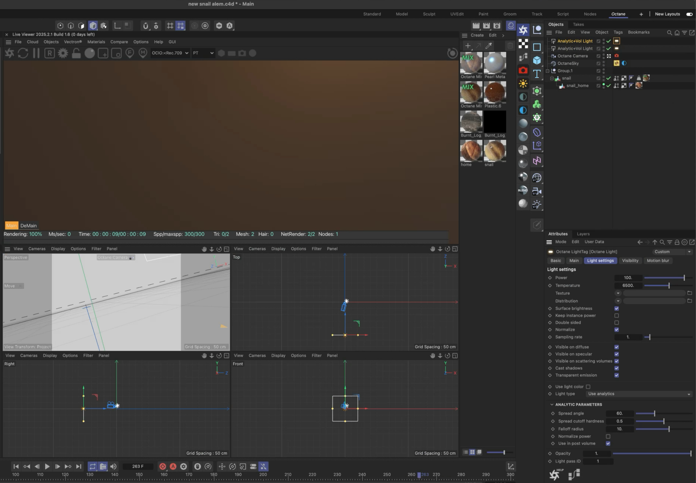

I have also found that when I add an analytic light + post efx, I get a CUDA error. I've tried adding to several scenes and I get the same crash when rendering. As soon as I delete, it renders fine. Scene file attached.

About "Safe frame" can you share some screenshots?
About Analytic Light + Post FX, you scene doesn't crash here, even adding a new one: But please avoid to use Mix materials, and convert them to Composite materials:
https://docs.otoy.com/cinema4d/CompositeMaterial.html

Ok, set the Opacity lower than 100%, even 99%, in Safe Frames attributes:
ciao,
Beppe

That Cuda error with PostFX was fixed in the very latest build (Octane 2025.2.1)panic1983 wrote: Fri Jun 27, 2025 3:09 pm When i set the safe frames opacity to 100% it doesn't add the black bars to show the aspect ratio in the preview window anymore.
